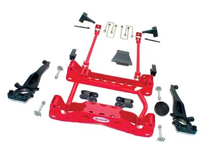

Of the three 4" lifts, Superlift, Rancho, and RCD - can you run factory rims/tires, just-in-case? Rancho says yes, does anyone have any experience with the superlift or RCD? I see the superlift has some sort of F.I.T. system that appears to bolt on as one unit on the bottom vs. other lift styles, anyone familiar with this? Anyone have pics of a RDC 4" lift?
I think you may be thinking of the Rancho with the connected subframe:
Here is the Superlift:
And yes you can run stock wheels on the Rancho kit. I have a picture of it in my gallery.
