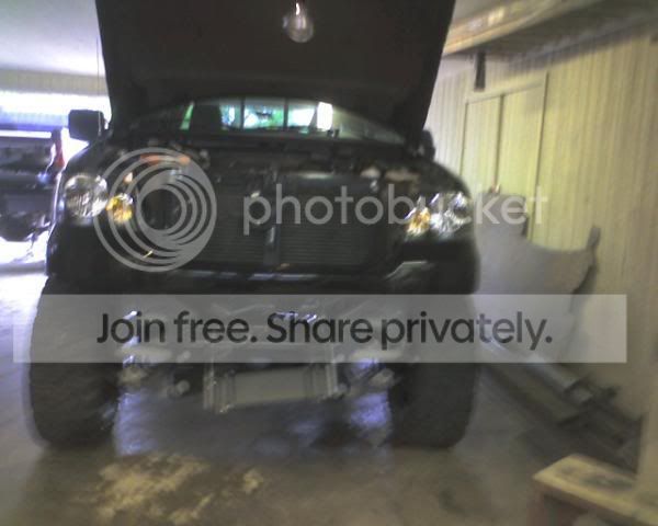

If you take the truck to a local offroad shop they may want to charge your out the A$$ for the labor on the body lift... i have a couple of friends who own their own 4x4 shops one did my suspension lift for free but then wanted to charge for the body lift b/c he thought it would be too hard... so me and a guy who own a better off road shop, took our time and got it done in 1.5 days
this is the picture of me starting the body lift
