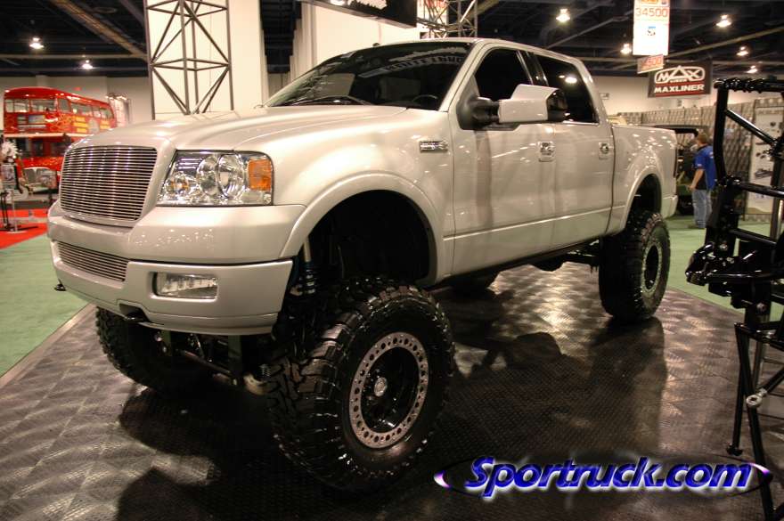

im fixing to have a pro comp 6" adjustable coilspring lift that will fit 37x13.5x20 mud grapplers just fine. with the coilspring adjusted almost all the way out it will be right at 7.5". with no rubbing and no add a leafs.
https://www.f150online.com/galleries....cfm?gnum=7113
