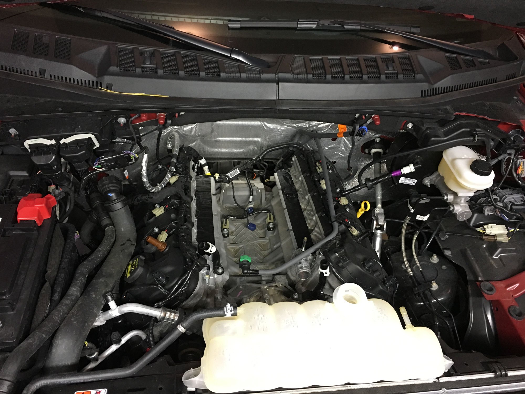

Engine bay prior to start

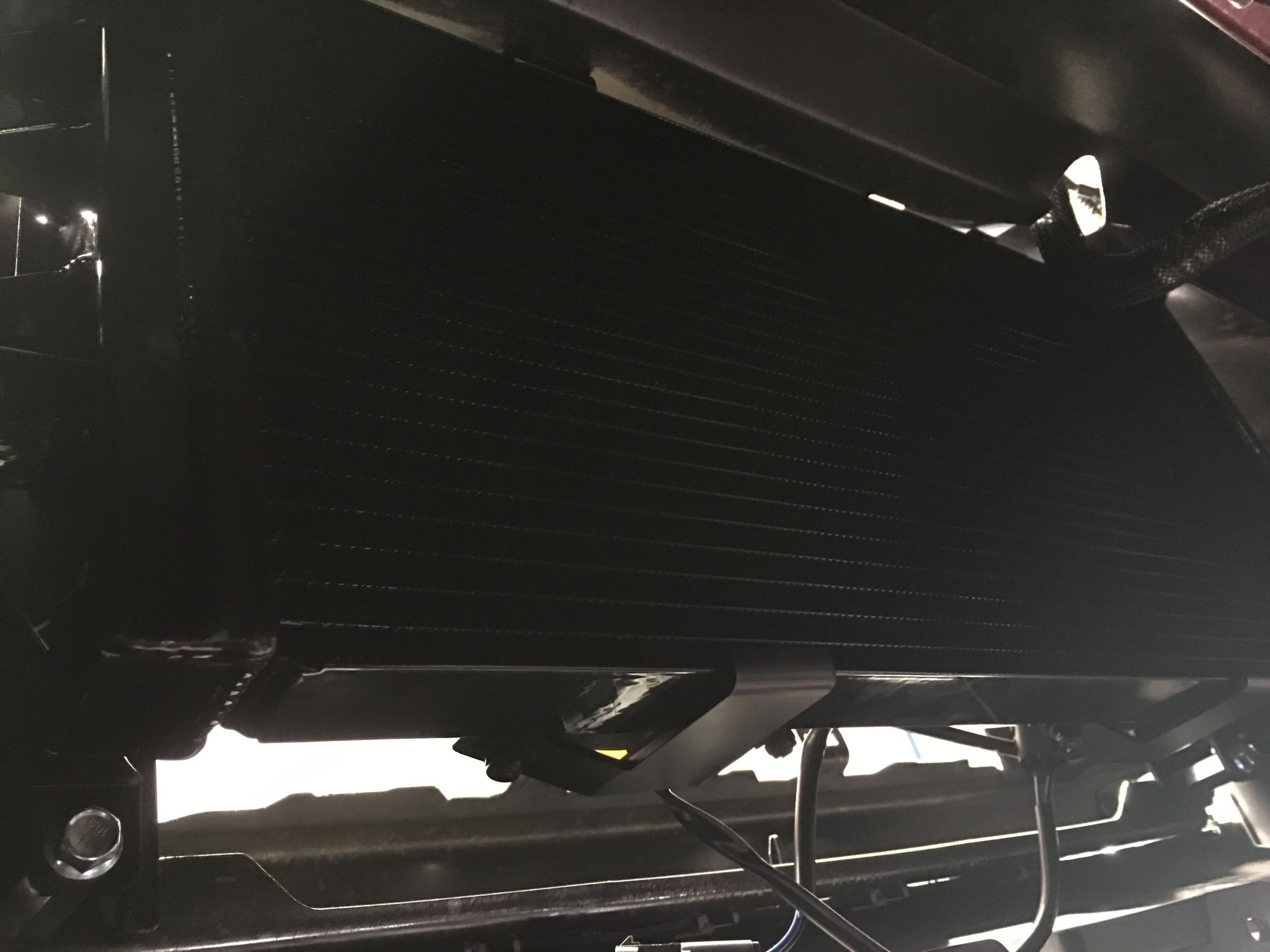

Dual fans & heat exchanger

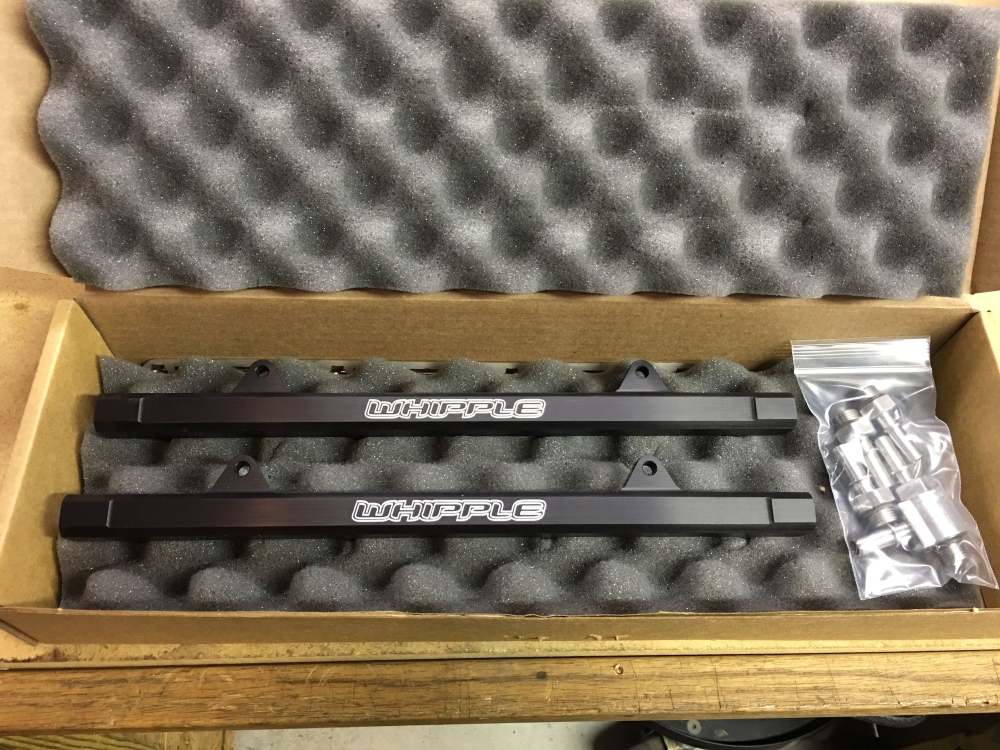

Billet fuel rails

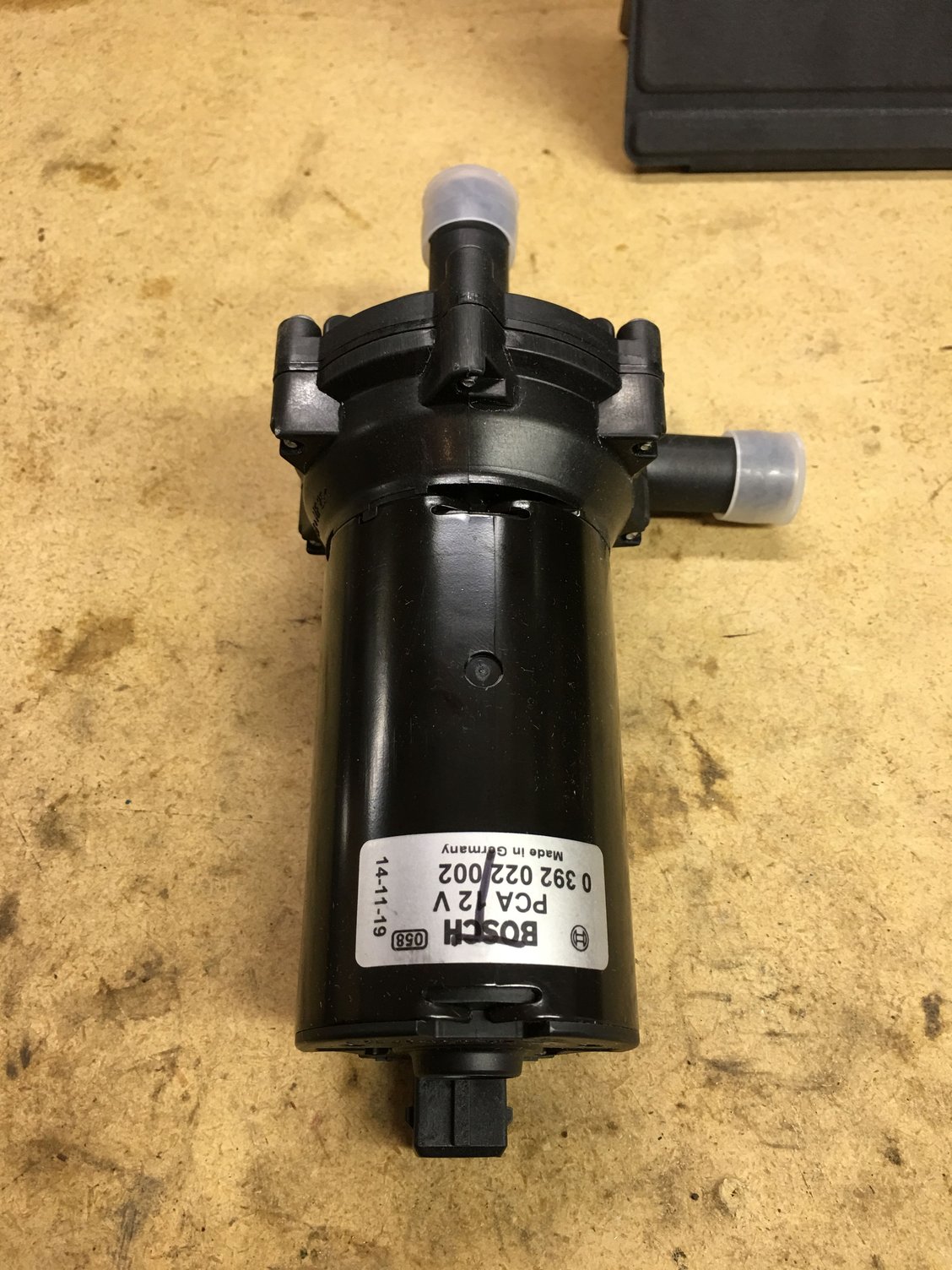

Bosch intercooler pump

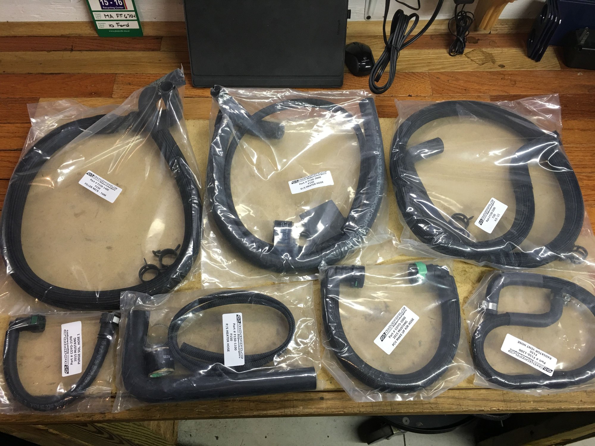

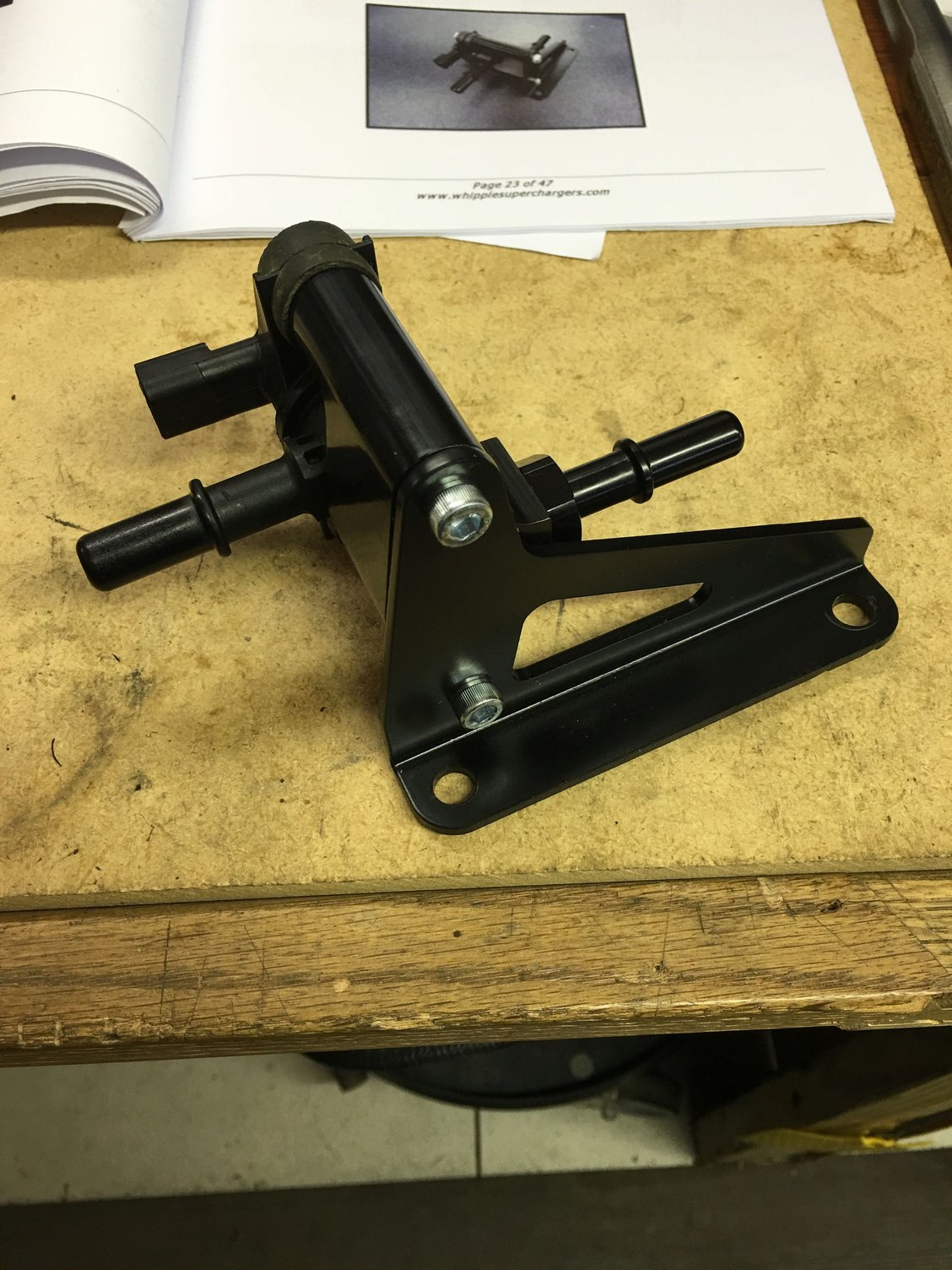

Another batch of pictures
Fan Harness and other wiring
Hose kit nicely labeled
More hoses nicely labeled
Assortment of parts in the kit
This it the fuel module that needs to be unplugged to relieve fuel pressure in the line before starting install. It is located just above the rear of the fuel tank on top of the crossmember

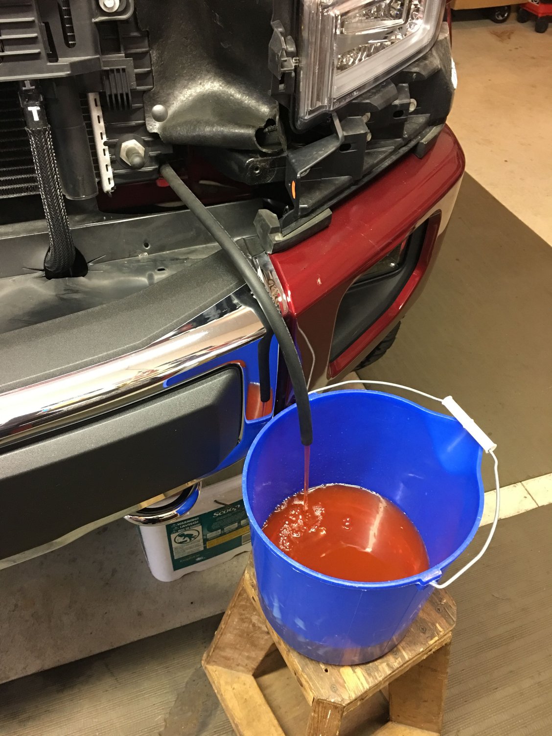

Length of hose to assist with a clean drain of radiator

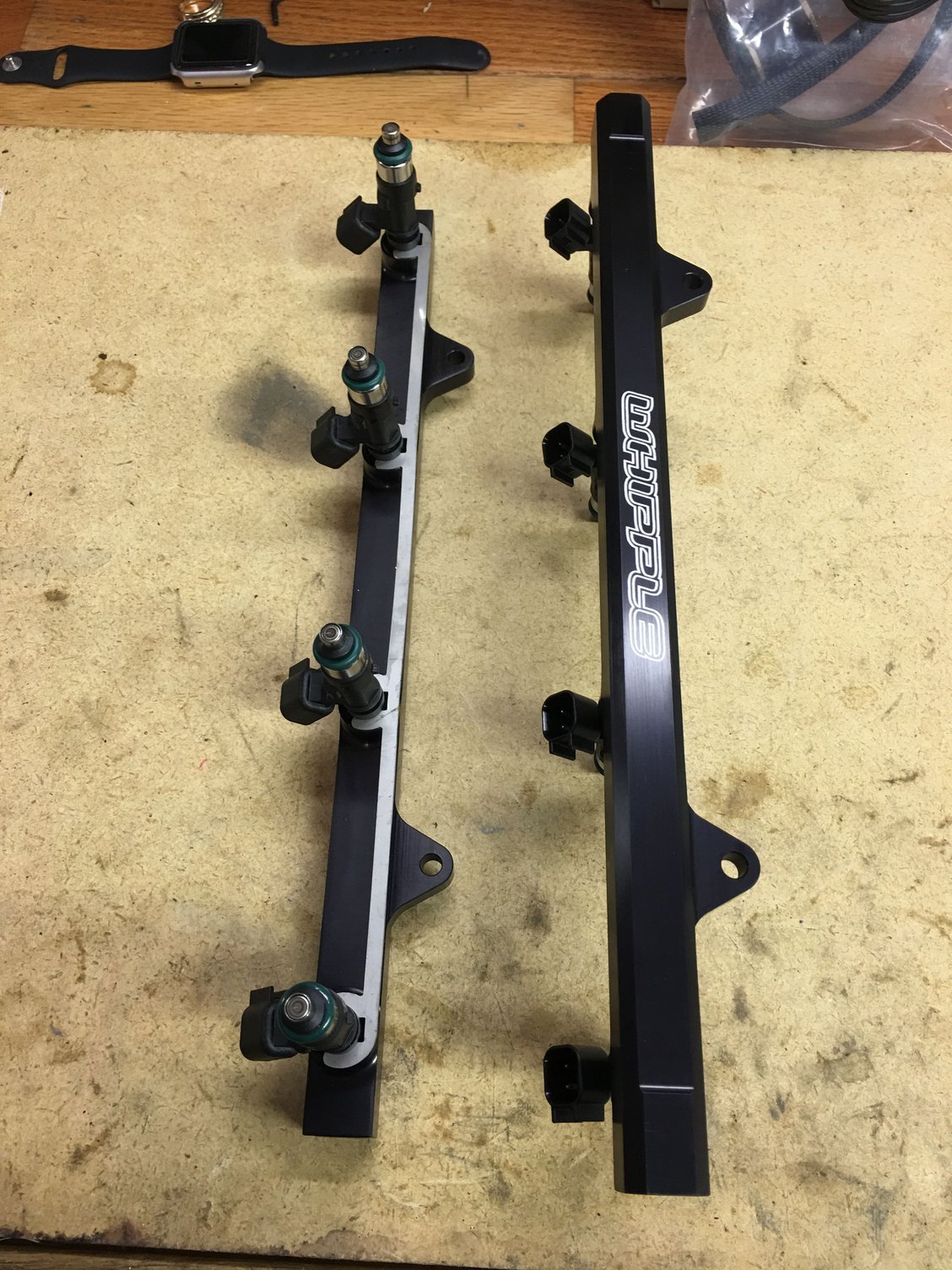

Fuel rails assembled
Fuel rails in place

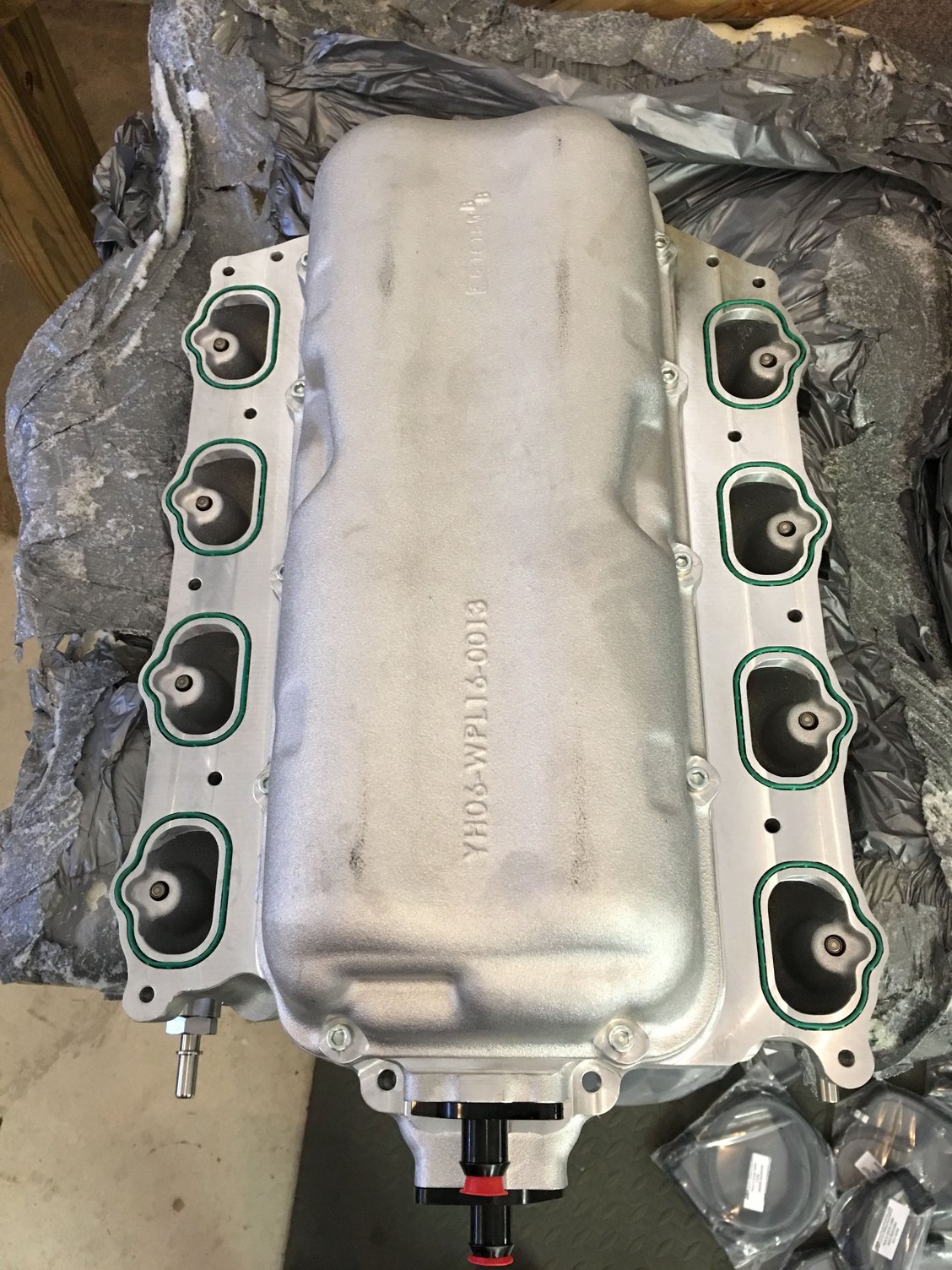

The underbelly of the blower
The massive intercooler
Lower manifold/intercooler installed. Now we are getting somewhere

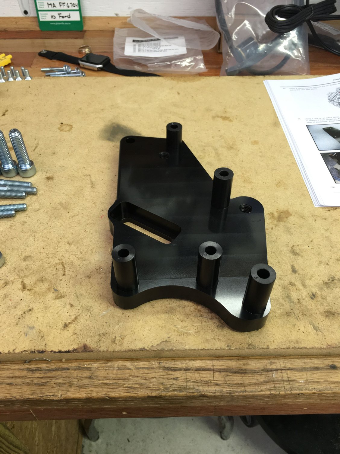

Pulley bracket assembled
Assembled

Heat exchanger in place
Front view w/ fans
