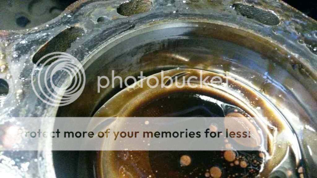

Old Mar 17, 2015 | 12:09 AM
Likes: 158
2002 IS 300
Engine bay
Removed plugs, #6 was very very wet with oil after the 60 second drive into the shop
Compression test, with corresponding plugs
After plugs removal/compression test
Tear down further
part of the intake, all of the exhaust still attached to the head, so we used the cherry picker
Stripped and inspecting for damage
And finally the bad news we were hoping to avoid
Pricing options with him, will update more once we know more

Hmm not exactly round is it? That's pretty crazy.

Never seen that before - but I have never messed with the VVTi GE motors. They are much weaker.

this is the first 2JZ ive been into, and I had a bad feeling after the compression on Cyl6 came back with 0psi
