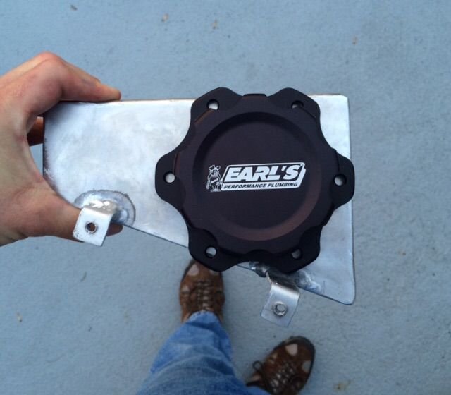

It's a treat. Been wanting to do this for a while. Finally got off my butt and designed a tank. Had a local fab shop build it. 1/8 alum with an Earls Plumbing 3" cap. Will be easy to add ice and lots of room for it too. The stock tank holds 2 liters. This one will hold 5 liters. It's also out of the way and in a cooler location. Will post final pics this weekend. Happy Halloween to all!
Have to do some filing on the weld to get the cap to sit even.

Nice. Be interesting to see if this speeds you up at all

It may help a little now though my temps rise very little. However this will clean up the engine bay and make for great cooling when I go built with more boost.

Here's the finished product! Cleaned up the engine bay nicely.
