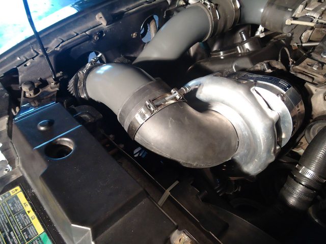

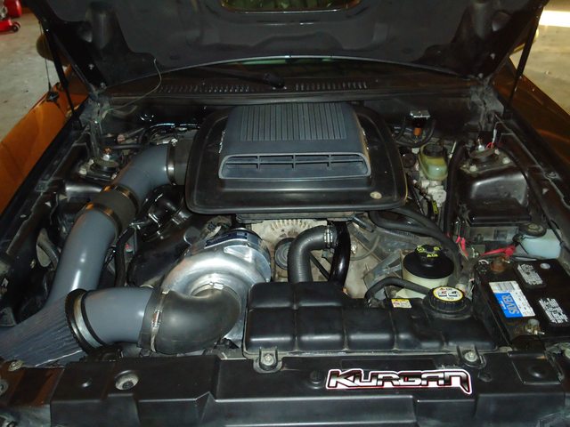

I see now the idler pulley is rubbing. I also had this issue. These kits can be a nightmare, something I did as well was so I wouldn'y have to remove the blower completly, I took a washer and notched it out and put it in between the idler pulley and the bracket. In the first pick, is the idler pulley rubbing on the INSIDE (closest to engine)? I know the way I adjusted was when I painted both sides of itblack, paint rubbed off silver so I knew where it leaked. I would try to shim it a hair (not too much or pullies will be misaligned), just enough for it not to rub. That is a weak link in the kit, I have replaced that idler twice due to squeaking and if it locks up belt is done. I would go to shop and have them add a THIN washer to get the idler away from the bracket. I am trying to figure out, is the small idler pulley in the pic attached to tensioner?? That idler pulley should be attached to the blower and not a part of your tensioner. Keep updating and let me know if I read the pic right.
Oh also in first pic I can see where your belt dust is coming from, I know that idler pulley is smooth with no lips , looks like belt is riding more on the back side of the pulley and hitting the timing cover (or bracket on yours), I can see the marks, you want to get that belt to ride more on the FRONT of the pulley, or dead center if possible, be patient, this will be a trial and error process to shim out the pulley since one thing in the kit will affect other things. For me it was bad enough I have swore next time I will go turbo !! I was changing 2 belts a month, went to a shop and paid $250 to have pullies aligned and STILL shreading belts, wind up being a weak tensioner. I can now remove blower and install belt in 45 minutes. You are at the finish line, now just time to tweak it in. I love the room you have to work with, check out this fit

Mach1. I will work through you questions one by one. But what I want to say us I love how youryour scoop is operable. I would like to work out air travel from my scoop to feed the intake.

Anything is possible with some fabrication. If there was someway to route filter with some piping over to the scoop, you would be golden with filter right in direct airflow, an added benefit would be cooler IAT temps! I like your paint job MUCH better than original lol I didn't notice, are you running a intercooler?. Where filter is now has to be sucking hot air, it needs to get some fresh air.

Yep running a standard 2 core.

That looks like a Thumprr Tensioner. Is that a tensioner at all or just a fixed point of the idler pulley??If it is, I hear stories of people having issues with clocking, machining and belt wobble. Man how long is that belt? looks LONGGGGGG !! They are a good tensioner overall., did it come with the kit?? So as not to have a pulley misalignment issue (there are alot of them!!), you may be better off removing it and having the excess material that is rubbing machined rather than shimmimg, I still believe the washer is the way to go, you will see it doesn't take much to get the clearance you will need, my friends laughed at me when I notched a washer, that is how much I did not want to remove the blower since my idler is part of blower assembly, this one for you is alot easier to resolve. For the belt slip possibility, again if tensioner is weak it will not be able to keep up with the tension blower will add as rpm increase and especially when you suddenly let off throttle, belt wil lhave a moment of slack and wobble before the tensioner catches up. All my belt issues went away when I bought a new tensioner (Goodyear Gatorback), also not sure what belt you are using, the standard is usually a Gates Microv AT or Goodyear Gatorback.

Pulley system is set up as per instructions, the tensioner is the ati tensioner that comes in the kit.

Back to the tensioner, referri g to the above pics, if I push on thetensioner body sort of where those three lines are, it will bring the pulley out about 2mm, which gives it the clearance it needs, my queston is... is the tensioner stuffed?
Should I rip it apart and look for signs of wear?
If you can push with the tensioner with your hand, it is no good. The way I knew mine was bad was I took 2 fingers and grabbed the belt between my alt and PS pump and I couls pull it like a bowstring and move the whole tensioner with ease. Normally you can't ripo them apart, spring inside just loses tension, like I state, best way to test it is if you can grab the belt and move tensioner back and forth with ease, get a new one..I would also check and see if you HAVE to use a ATI tensioner only. Oh, no, I am not offendable lol
Grab the belt right below the procharger pulley and the one below it and pull, while pulling if you can take your other hand and turn prochatger pulley (the big one), you need a new tensioner and that is where your belt slip is coming from.
