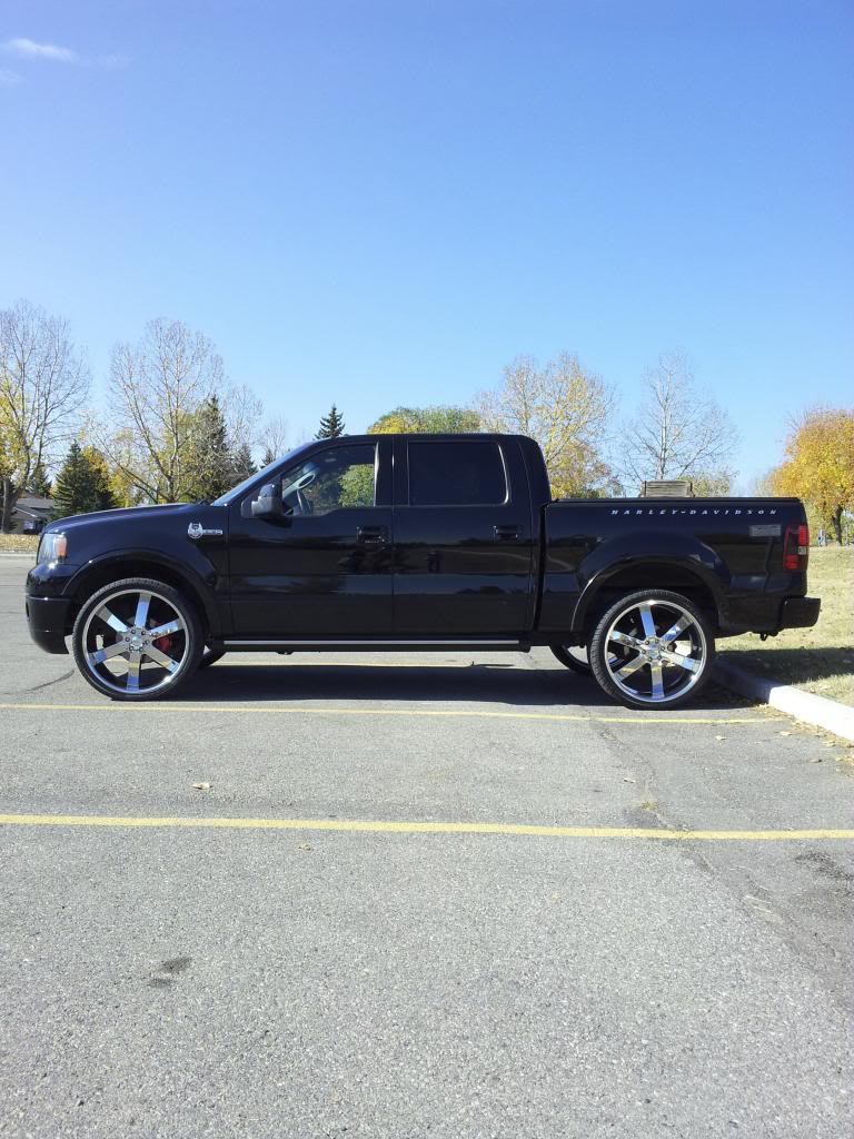

Heres a quick pic of my truck on 26's needs to be lowered though...next on the to do list...
Thanks for the lead twinskrewd, I talked to Jim Jr. at team Jdm and he anseered a lot of my questions and i think I'll order a tune from them. My biggest worry is blowing my motor but i guess its the old saying "pay to play"
Some guys even whipple say the whipple tune is safe then others say you will blow you motor even with the 8lb boost its hard to decide who to lkisten to........I just wanted more power out of my truck im not looking to break the sound barrier or anything
like i was saying I do run 26" wheels in the summer and next on the list is a lowering kit probably 2"f/4"r any recommendations on what is a good kit thats priced well?
