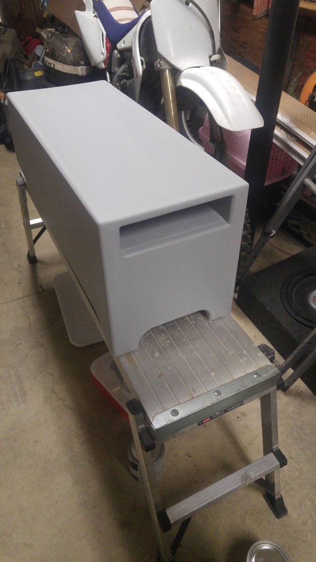

I ended up building a center console box. It's not finished yet, still going to get a dark gray leather top with cup holder. armrest and shallow tray for phone.
It's a down firing box that finished with 1.5cf (with port and subs deducted) ported and tuned to 32hz.
I just threw some diamond audio CM310D4 subs that I had laying around in there and I'm pretty impressed considering their wired at 4ohms because my amp's not stable at 1ohm and their only getting 300watts to both. They were in a sealed box their whole life and now to hear them in this box just blows me away. Sunglasses bouncing on the dash a even some door flexing. Can't wait to put some better quality subs in there
Primed and painted flat black with rustoleum furniture paint.
