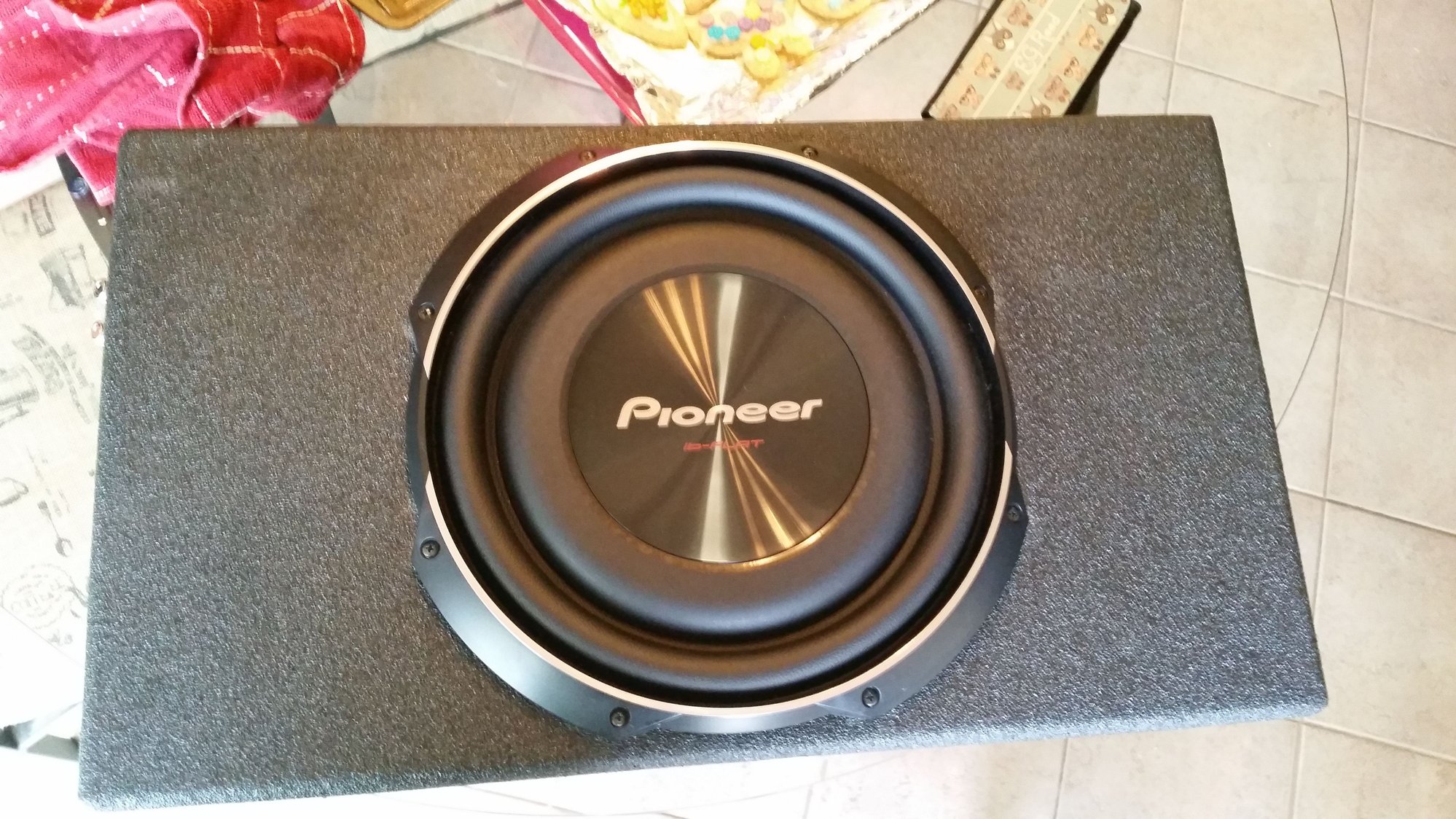

Posts: 12
Sub just came in mail. Fit perfectly in box

For the money invested I am extremely pleased with the results. This one subs hits plenty hard enough when turned up. I've got it adjusted to compliment my other speakers and not drown them out. Sounds really clean.
