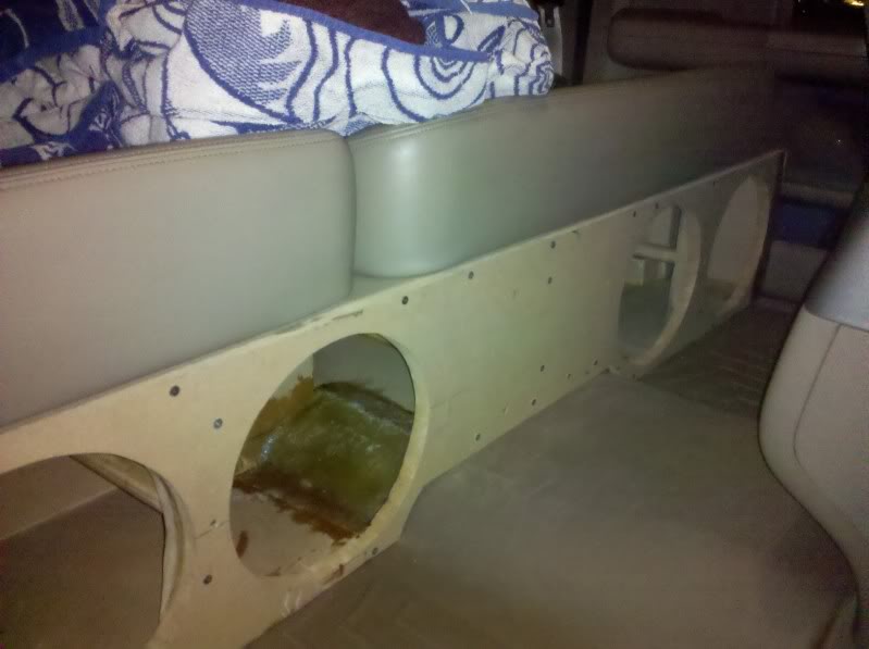

Four tens can fit but is a pain in the *** to build. Will require a seat lift, but id recommend two 10's ported over four sealed.
Did you build that yourself?
