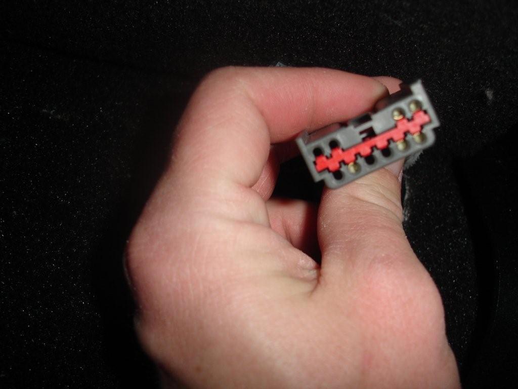

Is this what the Audiophile Sub plug looks like? I pulled it out under the drivers rear seat. thanks

That's it
Thats would be it... If you look behind your head unit, you'll find another plug that loops back into your wiring harness, it will be gray and will be plugged into a dummy connector. its directly behind your HU, you don't have to pull the HU off, just remove the wood grain or gray face off and its right there.
Sorry for all of that if you already find that one. All you need is a Factory Sub, and a Audiophile HU and your ready to go.
