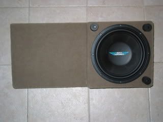

Search on Bazooka's and you can find some installs, but if you don't want to add a seat lift, then sell the bazooka's and buy the usual sub's most use here. This is one example, mine...
ImageDynamicsIDQ10Augs
