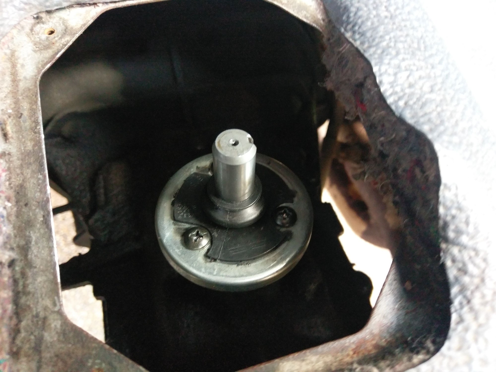

I have not personally opened the top of a M5OD R2 , but other kinds of floor shift I have seen , it is pretty obvious when the transmission is in some gear or in neutral. in neutral the shift gates are lined up so the "ball stub" can traverse between the shift positions. With that said, you are probably gonna to have to open it back up and put it in neutral or re-install the shifter in the 1st gear position. logic says that should cure the problem. Good luck.

Stub awaiting shifter install.
Stub with new top bushing.
Shifter kit install.

I would try to put it in with the shifter in 1st gear position first and see what happens

I strongly suspect the shifter stub is not sitting in the trans right. Or something moved while the stub was out. I moved the 4x4 shifter while the stub was out as it was in the way of trying to punch out one of the guide pins. Maybe that affected the trans position?
Someone suggested using a big screwdriver to put each gear in the neutral position...let me know if that makes any sense? Or how one would do that.

Okay, a simple job made difficult! But I finally got it to work. The trick was getting the trans back into neutral. Large screwdriver, depress the clutch and pull u-shaped cog down so that the shifter shaft can install between the two spring-loaded buttons. I imagine it would be a similar solution for the different gears.
The simpler solution would have been to have the trans in neutral BEFORE you take the stub out!.
The kit makes a huge difference. It's like a new transmission!
