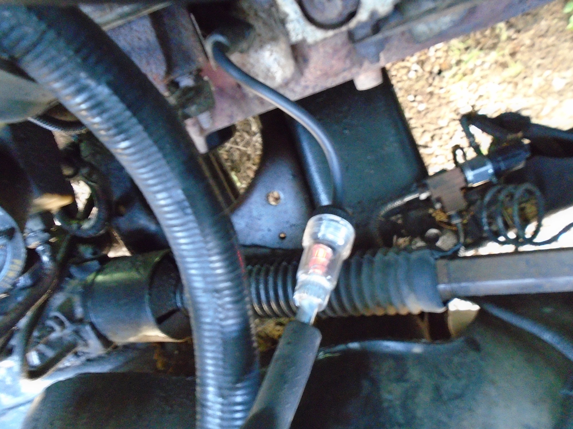

Ok, got my plug wire light installed and I will use a couple of zip ties to hold it in place and drive it like that. Does anyone thinks that's not a good idea? Light is working well and truck is starting great this morning. Digging up the fuel gage kit today and should be ready to verify spark and fuel pressure on next fail to start.

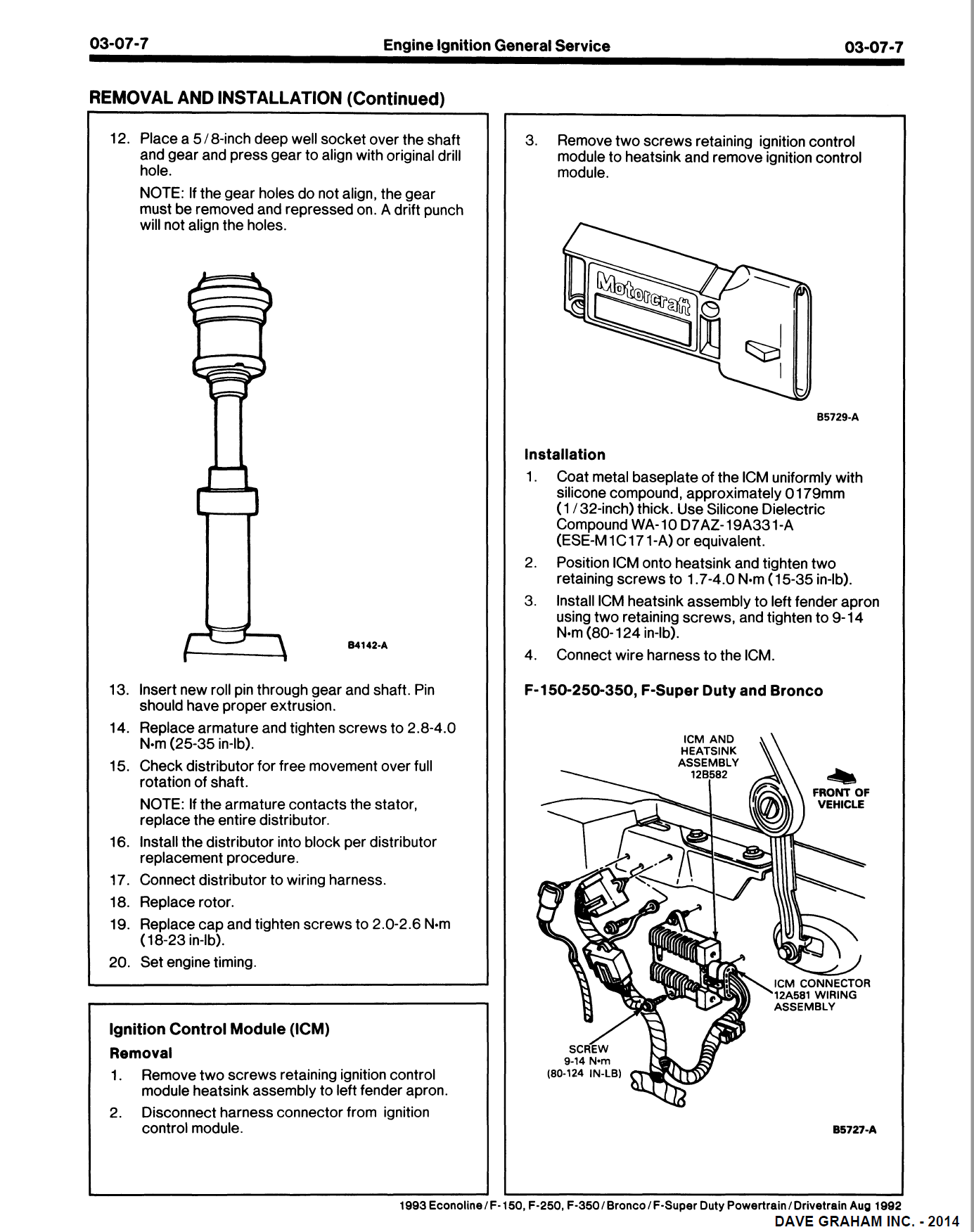

Ok, after 35 miles on a few short drives and multiple successful starts, I finally got a turn over with no start today. Fuel pressure was 35 & 38, but I had no spark to the plug wire I had the spark light connected to during start. No spark leads me to the ICM as I read on other threads. However, I am not sure how to T/S the ICM? Any tips how I can by sure its the ICM or that its not even getting spark to the ICM? IF the ICM is good, then its on back to the Coil right? I see in the manual the heat sync the ICM is connected to is suppose to be covered in dielectric grease when installed. As I look at mine, it seems very dry to me? I have not removed it yet. Could the ICM be good and just not getting a good ground at times which is causing the intermittent starts? Or could ICM's be intermittent also?

Are you sure the manual says dielectric grease, or does it say thermal heatsink compound? We use the latter in computers between the heatsink and CPU, and you don't need much at all. You want heat transfer, and grease doesn't conduct heat anywhere near as well as compound. The compound is only used to fill in air gaps between the item and the heatsink so you spread it out very thin.

You read my mind.... I saw some heat sink compound and I ordered it. Be here tomorrow but here is what I see in the Ford Manual for my truck. See attachment
I would rather use a compound deigned for heat sinks vs elect grease. Am I reading this wrong?

That is EXACTLY what you want. It's thermally conductive. I'd also clean out the fins on that heatsink thoroughly. Also clean the mating area on the heatsink thoroughly with alcohol, if it's not completely smooth hit it with some fine sandpaper. Make sure the mating surface on the ICM is clean and smooth.
I don't think I'd put it on as thick as the manual says, it only has to fill in air gaps and imperfections. Best heat transfer is actual metal to metal. If any squeezes out when you attach the ICM, clean it up.
