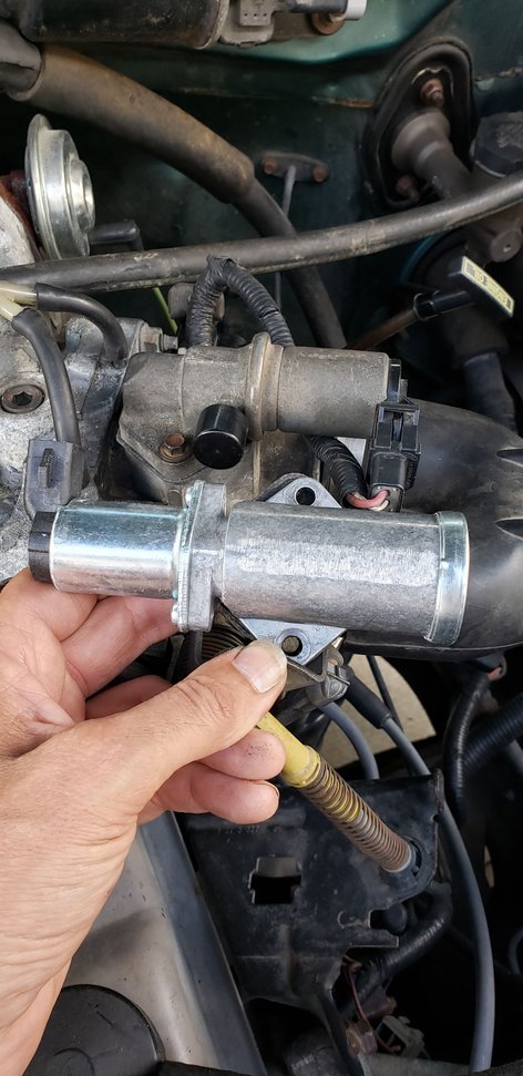

Ok was working on it a bit today. On a whim I put the original iac back on. Idel dropped to 950 ish. A little low end stumble. cleared codes took for a drive. All behaving . Scan again and have p0304 code returning. So the question now is. Are idel air control. Functional differences? Thinking the after market one. Physically larger. Maybe holding the valve open longer or something. Thoughts ?

Your aftermarket IAC is defective. You have an issue with a miss in #4 - cap, wire, plug, injector, or low compression.

stock iac reinstalled vs after market replacement I'd initially thought different mfg was reason for size difference. now I'm thinking they have different flow rates. The aftermarket took away the p0304 code but produced a p1506 code and high idel. 1200 + rpm. Will do a compression test soon.
