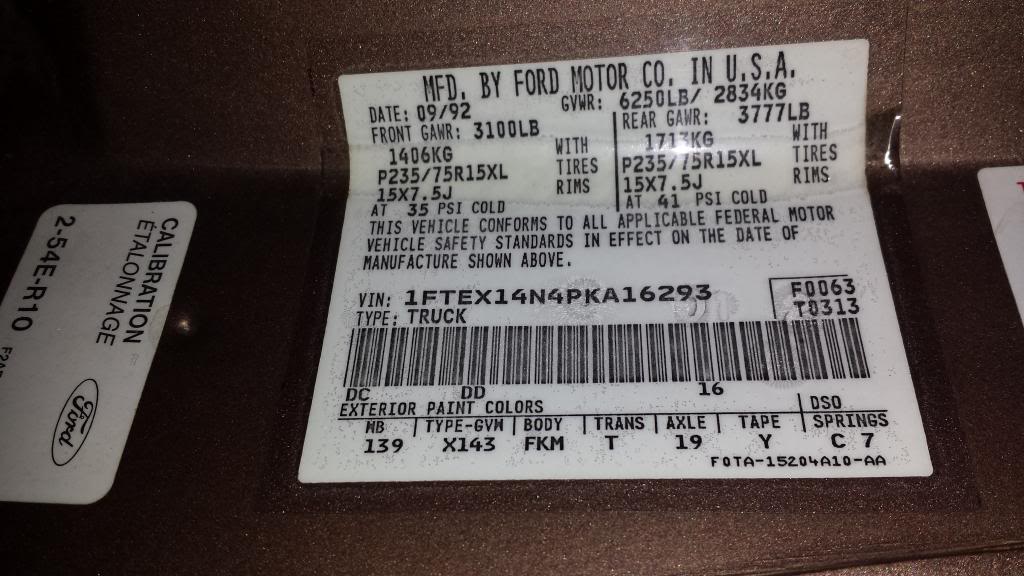

Basically what I really need to know is what my conversion constant should be with 33x12.50's
I have the stock axle but I dont exactly know how to read my door sticker.

You have 3.55 gears. Your stock tires were 29 inch. Hope this helps you do the math.
