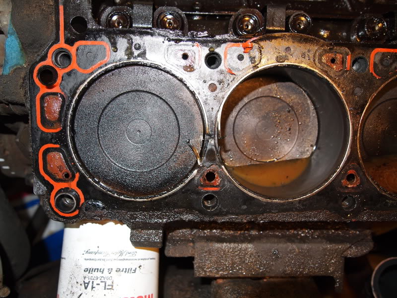

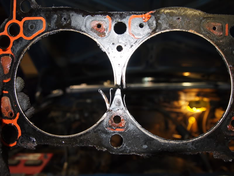

I decided just to dive in there and pull the intake and heads with engine still in the truck. No wonder I had lost so much compression on the #5 and #6 cylinders!

I've got two sets of fresh E7TE Mustang heads sitting in the garage I'm gonna bolt on instead of the E6's that came on the truck. I already deleted the air injection pump, and would like to delete the EGR while I've got everything apart. I'm gonna fab up a cover to bolt to the intake in lieu of the EGR valve. Any problems created with doing this? Thanks.
