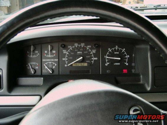

I have a 96 F-150 with the 300 six with the duel tanks. When the front tank is selected the fuel guage is buried way past the full mark regardless of the amount of fuel in the front tank. The rear tank seems to be reading o.k. It sounds like a bad ground??? Anyone else had this type of problem before I start messing with it.

You are headed in the right direction. When the tank is full, the resistance on the sender is "high" about 160 ohms. Empty is about 16 ohms. If the sender is unplugged, or the wire is cut, the reading would be infinite, causing the gauge to go past the full mark.

Past full = bad sender, have to drop the tank.
On E = bad connection either at the sender or the back of the cluster.
