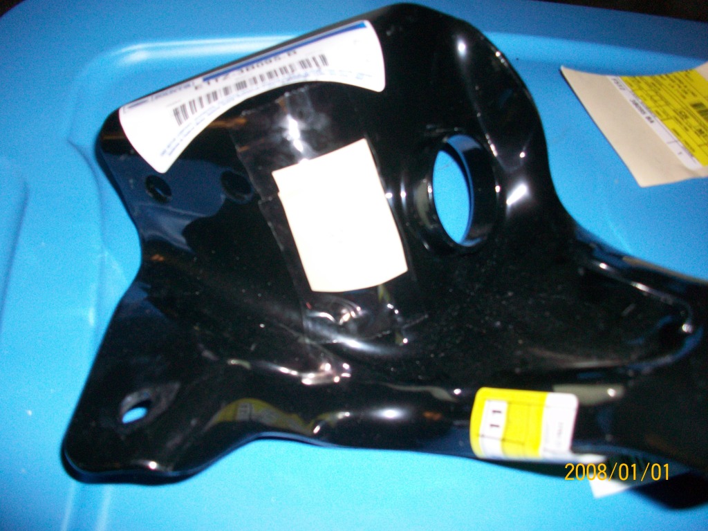

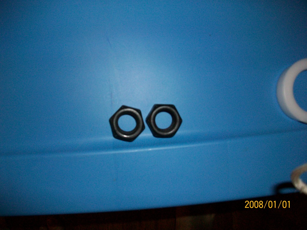

picture of parts and there part numbers
Here are some pictures on the radius arm brackets and some other components.

there are the part numbers (Notice the are for 2 wheel drive only)
left radius bracket # E1TZ-3B095-B
right radius bracket # F5TZ-3B095-BA
Radius arm nut 1 1/8 -34992-S2
Plastic spacer E5TZ-3B244-A
Also some grade 8 bolts are required i got 1 1/2 inches long
One one thing the are motorcraft part numbers i strongly incourage you to buy the ford arm brackets they are much thicker when stock and they dont cost a lot.
Hope this helps some people out. I am just trying to be as helpful as i can.
