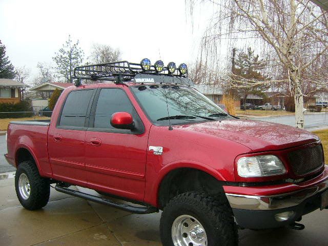

I too saw Scotts Truck & liked it....so I copied it, with a few minor changes!

Amazing. Both of your trucks look amazine. Mine looks exactly like yours but stock. I was wondering if you guiys could explain something for me about your roof racks. Do you guys have sunroofs on your trucks? I like the look of the rack but i have a sunroof and i want it to still be funtional but i dont know if it will be. Any help will be great. Thanks

I don't know about the sunroof...If it is the type that just slides back I think you'll be allright. If it is the kind that pops up you might have a problem. There is about 6" clearance between my roof & the bottom of the rack.
