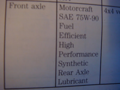

Everything I have read says to use 75w-140 in the rear if you have the 9.75 or the 8.8 diff and the 75w-90 is for the front only. Make sure it is a GL-5 oil.

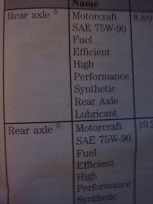

This is my manual, should I still use 140?
And I already have the friction modifier, thanks to this forum.

I called the parts guy at Ford and he said to use the 140, so I guess that's what I'll do.

Owners manual does say 75w90, but Ford has since change their recommendations and now state 75w140 replace the 75w90.

Your manual says 75-90, do it! Mine says 75-140 and is a 2000 3.55 L/S 4X4. I have to put 75-90 in the front axle. Differences? I don't know but I have Amsoil severe duty 75-90 in my old car, 9" with a locker, 35 spline axles and 3.70 gears. Maybe it's for heavier duty stuff, I can't say. Either way, add a bottle (they are small) of friction modifier.
