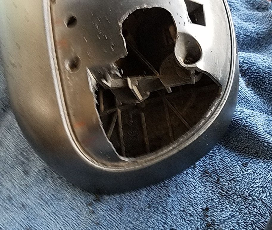

Thank you! The wheels are TSW Max 20x10 and the tires are 295/40/20. I added the turn signal mirrors to both my truck and my expedition. The truck was prewired for it so I didn't have to
do a whole lot. The expedition has heated mirrors so I found mirror caps and turn signals and dremeled the housing to fit the new turn signal and the caps mount the same way as non turn
signal mirrors. I then ran a wire to give the turn signal and the power heated mirror had a ground there already. If your truck is a XLT or higher there is good chance it's already wired for it.
