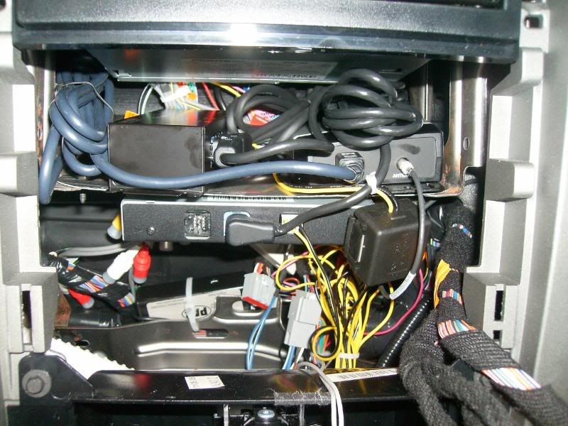

Well I finally got around to installing my AVIC-D3 this weekend. I also installed the optional bluetooth adapter, steering wheel controls, Ipod cable, and Sirius Sat tuner. The install went smooth and is very easy in this truck. There is a TON of room behind the dash, almost too much. I quickly fab'd an aluminum tray to install all the add-ons to. Velco saves the day.

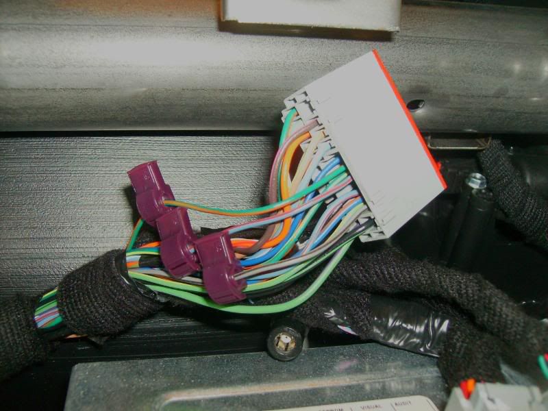

Here are 3 wires you will need to tap for the install. Gray/black is VSS, and the other two are for steering wheel controls...lt blue/red and green/orange.

Add-ons tucked away

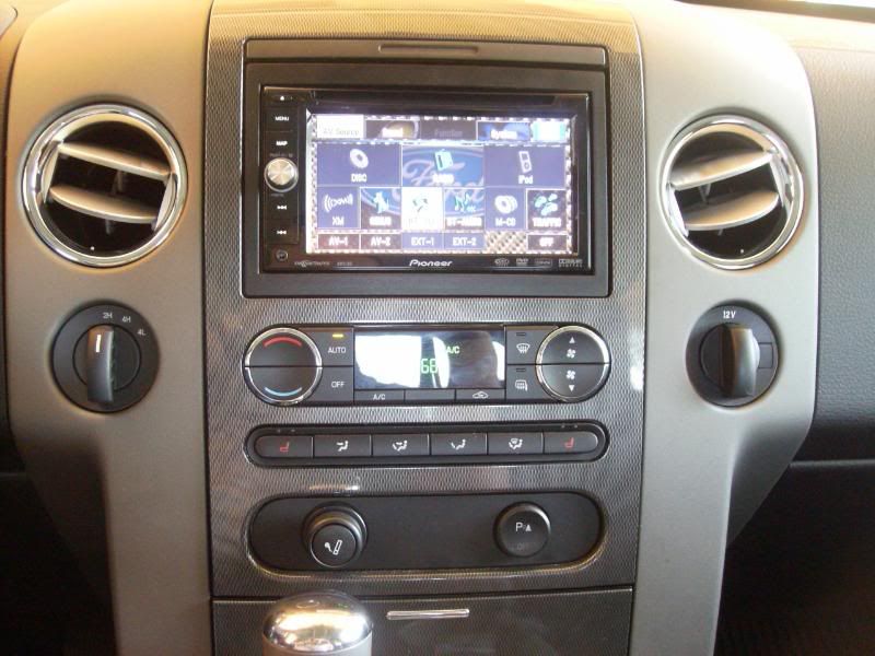

Install complete

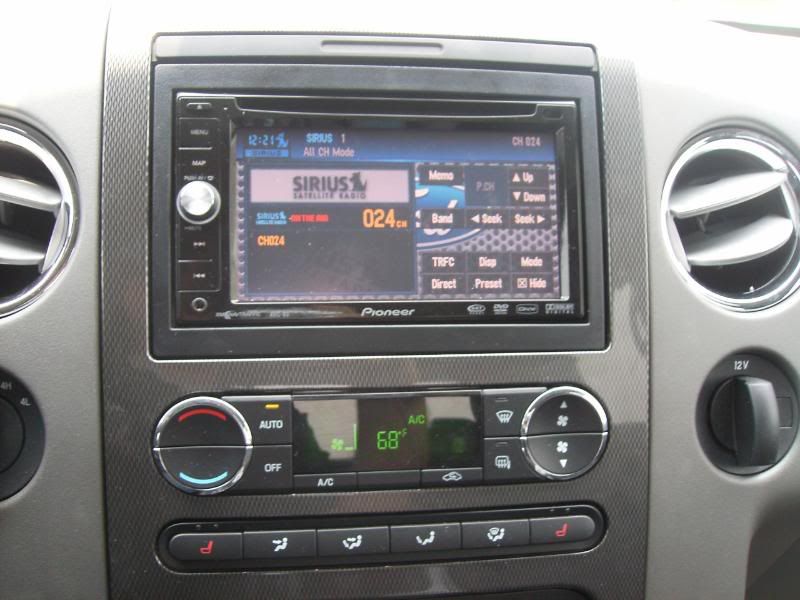

Sirius screen

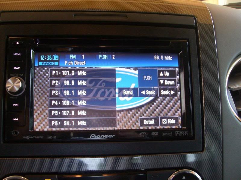

Radio screen
