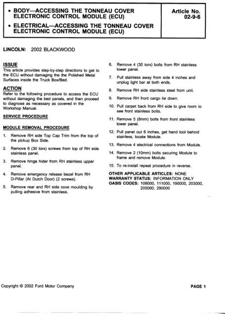

It sounds like it might have one or more bad motors. There is a power window type motor on each side of the bed. posibly only ofne motor might be weak and the other can't support the weight. Either way they are not easy to replace. Just like the module. you need to take the side panels off for access.

here's a copy of the instructions
