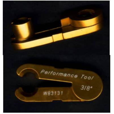

I just finished replacing a rear fuel tank on my '95 (non-L ;(). I have one of the plastic tools and have used in to swap filters. The filter fittings and the return line came off no problem.
The supply line wouldn't budge. One of my friends came over with a slotted metal type tool, no luck. In this case I was glad as he had ragged on my for my lack of ability.
Anyway, went to Pep Boys and found this one.....
Click, pull, off. This thing was $7, the POS plactic one I had cost $5. Sometimes a different tool will do the trick. In the case of fuel filters I have also found that unbolting the bracket gives you a better angle on my truck.
Good luck.....
