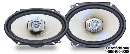

They are 6x8's. The Pioneer 6x8's have "Custom-fit for Ford and Mazda vehicles" stamped on the edge of the woofer. The stocks are 6x8 but that's not saying 5x7 or 6 1/2's won't fit, I can't say. I used the 6x8's.
