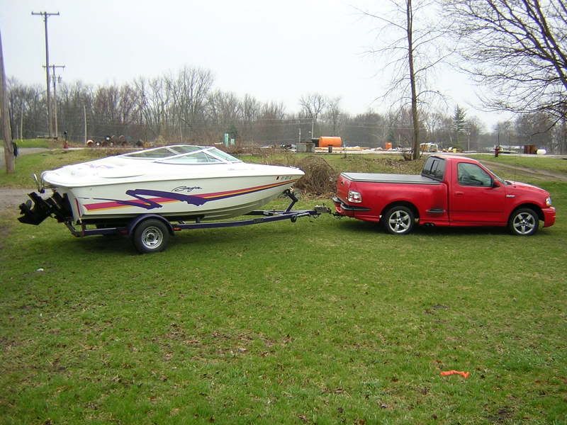

It's going to be spring soon and I want to do some mods to the L. I already have a tune and a K&N intake. I would like to get a #4 pulley, FTVB/4x4 pan, ported plenum, accufab TB, and trac bars. I would like to do some drag racing this summer but I also pull a boat to the lake, so I would like to keep my towing abilities, and run in the 12's at the track. What kind of risk would I be taking by doing these mods and towing with them? What mods do you guys have and still tow with? BTW the boat is a 18' Baja.

Your setup seems to sound exactly like mine. I have about the same mods and am about to begin pulling my 83 18' baja bass boat. (115 merq.) about 2500 pounds all together. You really don't run too much of a risk with those mods. Just keep it out of overdrive unless you are on a long stretch of flat interstate. Also don't get into the boost too much. You should also try to hook up the trailer brake if your boat is equipped with it. What kind of baja do you have?

It's a '97 Islander with a 350 Merc. Don't know the weight though.

I've towed a few thousand miles with my unmodded 04.
I pull a 5k toybox to the sand dunes. I burned the tips on my Bassani cat back and didn't think I was staying in the boost that often for that long.
If I was to do mods or continue towing with it. I would put in a Pyrometer to moniter the exhaust temp.
The truck pulls it great. Engine and tranny temps stayed down. I run with the overdrive off and RPM between 2.5 and 3k.
I did install a tranny temp gauge and only saw it hit 200 a couple times on some long mountain passes.
It's a sweet puller with the stock wheels and F1's it tracks real straight without wagging. One winter pull I put on my 235 70 16 winter all seasons. It would wag a bit when the big rigs passed but did all right.
MPG dropped to 10.
The trailer brakes were a peace of cake plug and play pigtail and that little hole in the dash took my techonsha without cutting.
Hope this helps. I say go for it but don't get crazy showing off on the hills. It's fun to leave the deseils on them big hills.

I pull boats with mine all the time. That's a big part of why I bought it. I have to able to tow with whatever vehicle I own and I didn't want a regular truck.
I don't pull with a 6lb pulley, and I have a low timing tune specifically for towing/cold weather. I use the 4lb pulley and have many other mods and it does great. As mentioned before, don't get into the boost, and you'll be fine. You can tow with overdrive, just wait till you're at highway speeds and not going up steep hills.

Upgraded to JDM heat exchanger, e-fan, 170 Thermostat, C&L plenum and elbow, JDM cold air, Accufab throttle body, 58" long bars, JDM line mod valve in trans,SCT 2400 mass air, 60lb injectors and AVT Performance tunes on a XCal 2.
I don't step in the throttle hard when I'm towing, but the transmission is strong in the these trucks. Good luck, FDuce.
