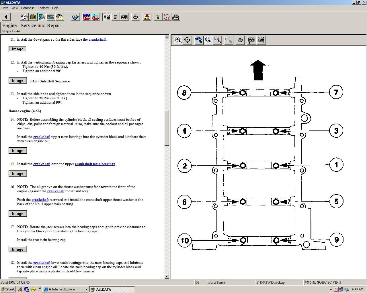

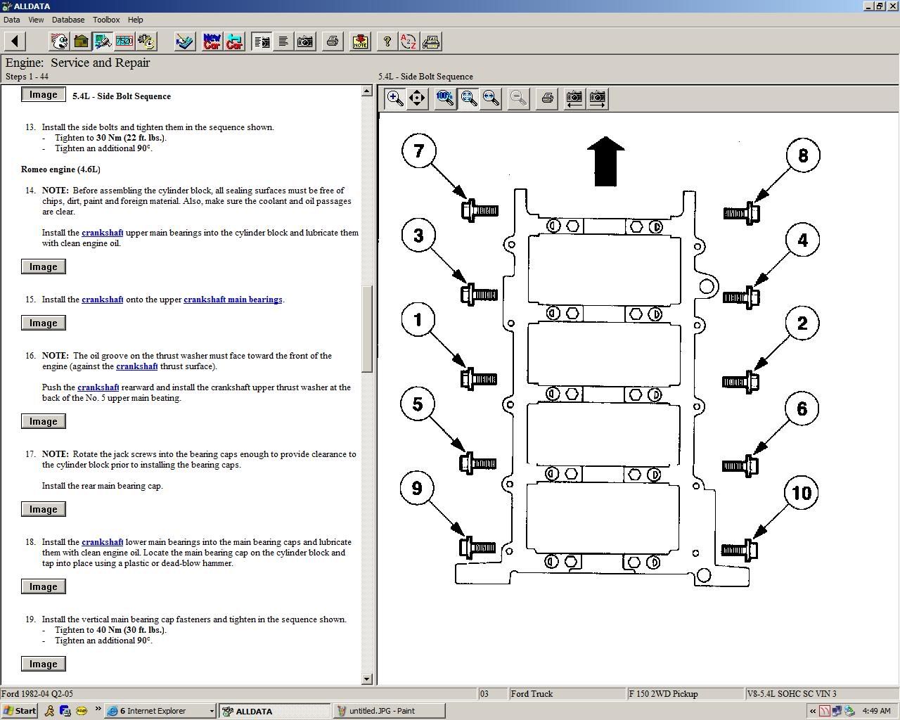

Ok i got 2 question.
1) what is the torque secquence for the main's, I bought main studs but the shouldn't really matter. so whick ones to torque first the sides or the top first

Thats cool bro that all i need to know about that?
