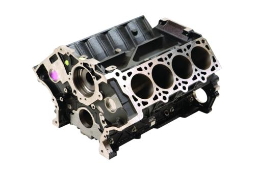

BTW for those that dont know NVH is a redesigned "reinforced" 5.4 engine block (noise, vibration and harshness), reduced engine noise by 3.1 decibels.

Al Sat night I kept saying Noise Vibration and Harness, now that was some funny chit
But actually I am right on with this one, I SWEAR Check it out
http://www.performanceparts.ford.com...tKeyField=8447
or
http://media.ford.com/article_displa...ticle_id=12090
M-6010-M54**
Production 5.4L block
Windsor style main cap locators
90.2mm bore size
Newer casting design features lower end improvements to minimize noise, vibration, and harshness
Ford Motor Company’s research shows that its attention to powertrain refinement levels and engine sound quality is making a difference to customers. Ford engineers have made a significant number of improvements in noise, vibration and harshness (NVH).
The Improvements:
Redesigned engine block.
Engineers reinforced the engine block
And reduced overall radiated noise by 3.1 decibels.
