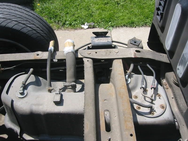

It is simple to remove the bed. I just finished mine for the fuel pump install.
First remove the 6 T 50 bolts
Then remove the three bolts for the fuel inlet
Then there is a small band under the fuel inlet you need to take off from the under side of the truck
Then there is a wiring harness for the rear lights under the back drivers side disconnect it
There is also a vent for the rear it just pulls off no worries.
The bed is not that heavy we moved it with three people
I really did not take it all the way off just slid it back on and changed the pumps

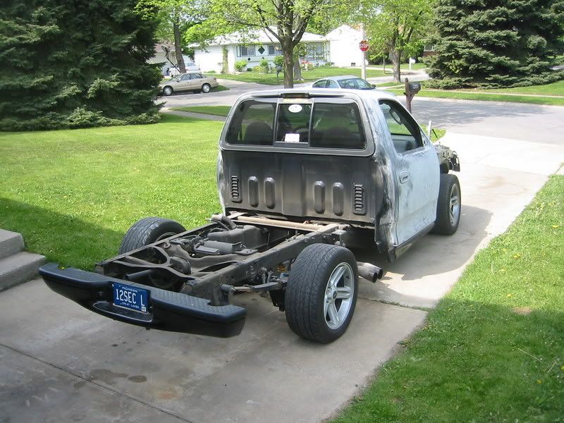

i dont have step by step pics... but some food for thought
its really easy to do. from what Jace18 said
-First remove the 6 T 50 bolts
-Then remove the three bolts for the fuel inlet(open your gas door and thats where they are)
-Then there is a small band under the fuel inlet you need to take off from the under side of the truck
-Then there is a wiring harness for the rear lights under the back drivers side disconnect it(its on the frame rail on the drivers side)
-There is also a vent for the rear it just pulls off no worries.(its in front of the spare tire i believe)

Thanks for the picks. By any chance do you have a shot of the rail from the drivers side so i can see the stock front hanger?
Thanks
