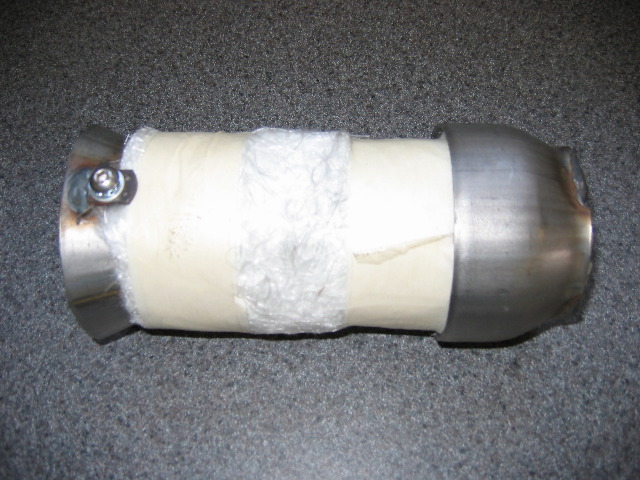

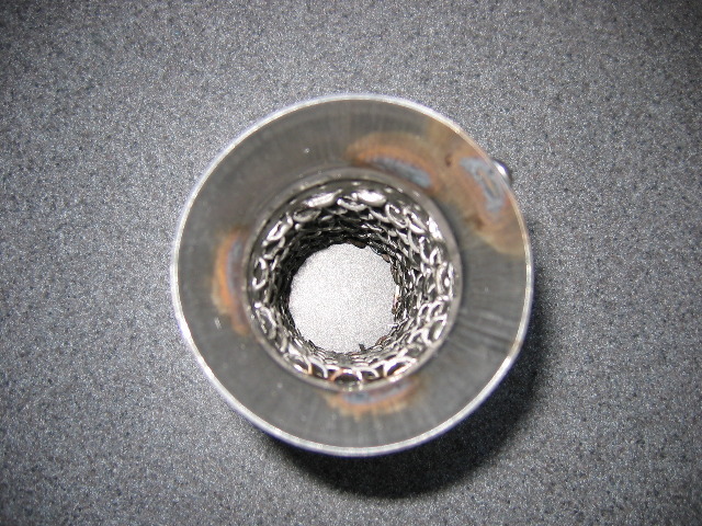

Great info Jody, Can you go into more detail on the baffles?

They're kinda pricey at $135/pair. But they do take some of the interior tone out, it is noticeable but not dramatic. They are made by Bassani but would fit any similar diameter tips. By the way, the tape is on there to hold the packing in place; you remove it when you install them in the tips.

Wow the price must have changed. From Bassani
All baffles that we have are made to fit Bassani cat backs. They have no part numbers and they are not guaranteed to fit any other application and they cannot be exchanged or returned. They are stainless steel and the cost is $35.00 EACH plus shipping. You will have to tell me the ID of your tip and the length where this is going to fit. Your tip will need a small hole in the bottom to secure the baffle.
See attachments, wrapped in fiberglass cloth, held in place by masking tape. In picture 2, you can see the receptacle for the set screw.

I'm going to have to check with my vendor on that one!
