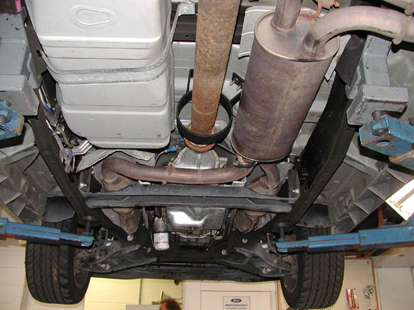

How hard is the jdm driveshaft loop to put in by yourself. I was just wondering because i heard from some people that you have to take out your seats in order to drill through. I thought it was a simple bolt on but i guess not. Anyone in here offer there opinions and instructions in order to put it on.

Most of us take the seats out to race, no biggy only a few minute job. Of course you also have to drop the Drive Shaft and break out the Drill, so I got to guess it's gonna take an hour or so.
I have the PSP 2 pcs set up that bolts right to holes that are already there, so sorry I can't be of any help other than that
Here's a couple of pictures
Doug's (Silver_2000_!)
Don's Bolt
and some great reading

i had the jdm d/s loop. it was a wellbuilt unti except for the install and it kept rubbing when i hit a large pothole or got a lot of rear suspension movement. i took it off and got the PSP Loop instead

that looks like my metco!!
Okay if its the same no seat removal needed, just take the 4? or the screws out of the storage box, pull it(is simple) then slide the seats up and walla!! your in!!
We did use me standing on the bolts while Scott Dunn air wratched them down!!
Put the box back in..your done!! oh and remove the driveshaft!!!

2. make your own for $20.00.
It IS a Metco!
