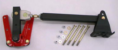

Oh ya,
these are your other choices
Upper Link System
OR
A Lower Link System

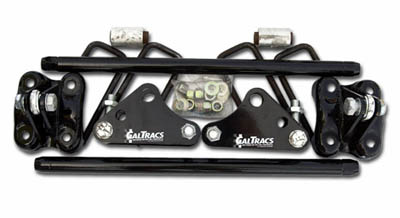

Cal Trac's
(I gave serious though to all of these) but I was told you need to adjust them for diff conditions, and they say that can be tricky,
if you don't know what your doing. (I don't know what I'm doing)
