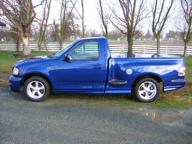

Here's Mine

Old Feb 10, 2004 | 11:22 PM
AmoJohnny's Avatar
Joined: May 2003
Posts: 636
From: Los Angeles
After...
Although, not noticably much online, I do notice a small drop in person. Though it is not level, Im content.
