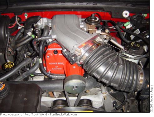

Old Feb 7, 2004 | 08:00 AM
The Swede's Avatar
TRUCK OF THE YEAR - 2010
Joined: Feb 2002
Posts: 678
From: Sweden
Here´s mine:
