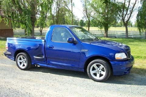

I have an 03 that I just got to the right hieght.I first installed 2'' shackles and was'nt happy,so i baught some 2001 rear leafs from a fellow lightning owner and Im now sitting perfectly level and never had any vibration pboblems.Ill try to take and post some pics tommorow.(By the way the pic below is with the 2'' shackles only)

This is the Roush springs front and back and a 2" shakle using the 1" hole...

I disliked the ride height of my 03' as well so I tried putting some 2" drop shackles on to see what they would do. Then I also purchased some 01' springs off a member here and swapped the 03' springs out for them. I did have a little vibration in the rear with the shackles, so when I replaced the springs I flipped the 03' shim around and feels vibration free.
Here's some pics of the differences
03 springs in back and 01 springs up front. Not much difference in height, but quite a bit of difference in stiffness and about a 1/16th difference in height on each leaf.
Before: 03 with 2" shackles After: 03 with 2" shackles and 01 springs
Some measurements (from center of wheel):
Stock:
Front - 19"
Back - 21.25"
Stock w/2" shackles:
Front - 19"
Back - 20"
01' Leafs w/2" shackles:
Front - 19"
Back - 19.25"
Either way you decide to go, 3" drop shackles or replace the springs, will make the look alot better. I decided to go the spring route because I got them for a pretty good deal and didn't like the idea of having the "extra" play of a 3" shackle. Good luck!
