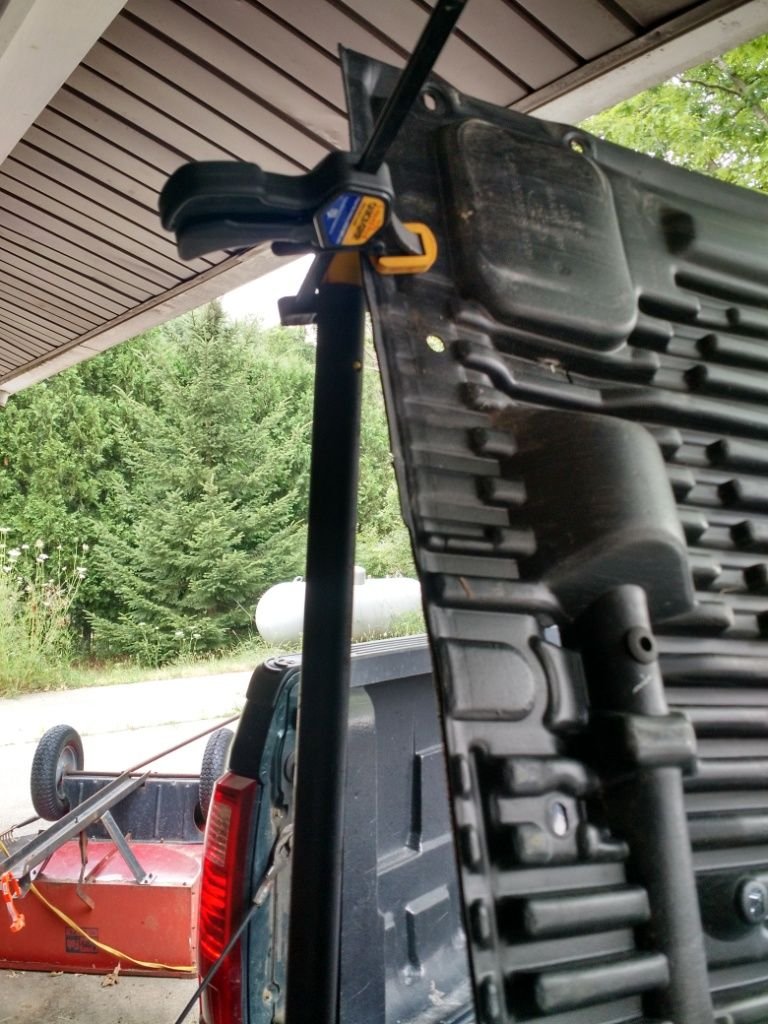

tailgate with step ....
Getting to the tailgate handle mechanism, tailgate with step and assist bar. (This is a 2012 F250)
Clamping bed liner to assist bar to access the tailgate handle mechanism, tailgate with step and assist bar. (This is a 2012 F250)
I want to add a couple of photos of my F250 with the tailgate step for those who come across this thread looking for answers, as I was.
Mine had only the bed liner. I was able to use a T27 to remove the bolts ( a little loose, but worked ok). However, the handle is attached with a large torx bolt and I could not remove it.
The liner also had 6 or 8 push-in caps that are threaded (sorry, don't know the name of them). I used a claw hammer to pop them out by lifting the liner, gently.
There was no metal cover plate under the liner. I had to raise the assist bar to the upright position, then I clamped the bed liner to it. That gave me access to the tailgate handle mechanism.
I opened the clips, moved the rods slightly, and closed the clips. Cleaned everything up, lubricated as needed, and dropped the liner back down and reassembled.
