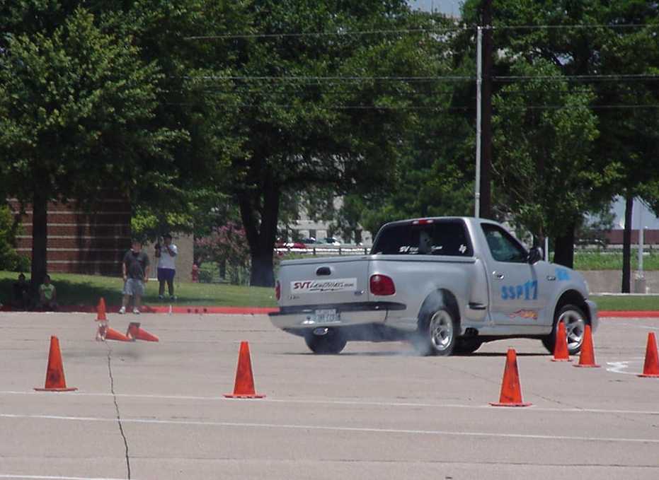

Darn, I had Sal and the Pawn agreeing with me and it didnt help the member.
My info about diff is based on hanging out with crazy guys with 4WD Jeeps. They had lockers that couldnt hardly be driven on the street. Hardly any slip at all at any time. On the right surface off road the Jeeps would plow through a corner cause the inside wheel tried to turn the same as the outside...
The TALON guys have pictures and video of mine doing 1 wheel peel on the autocross and that is normal. I was coming out of a corner the smoking tire was unweighted, yet they all were telling me my diff was shot. A year or more later I pulled 1.8x 60 foot on f1's and a 12.28 on et streets. Its working well enough for me.
