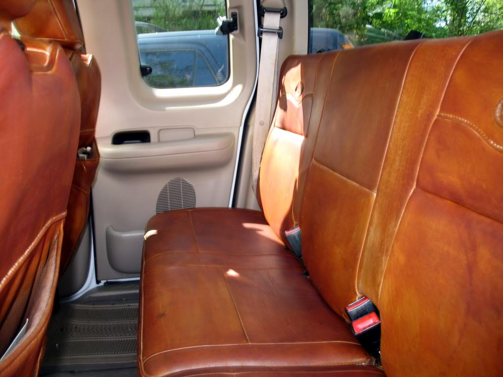

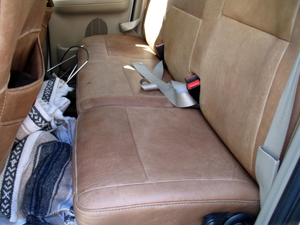

Here is what my seats looked like before

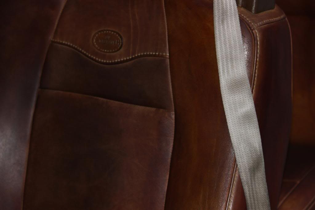

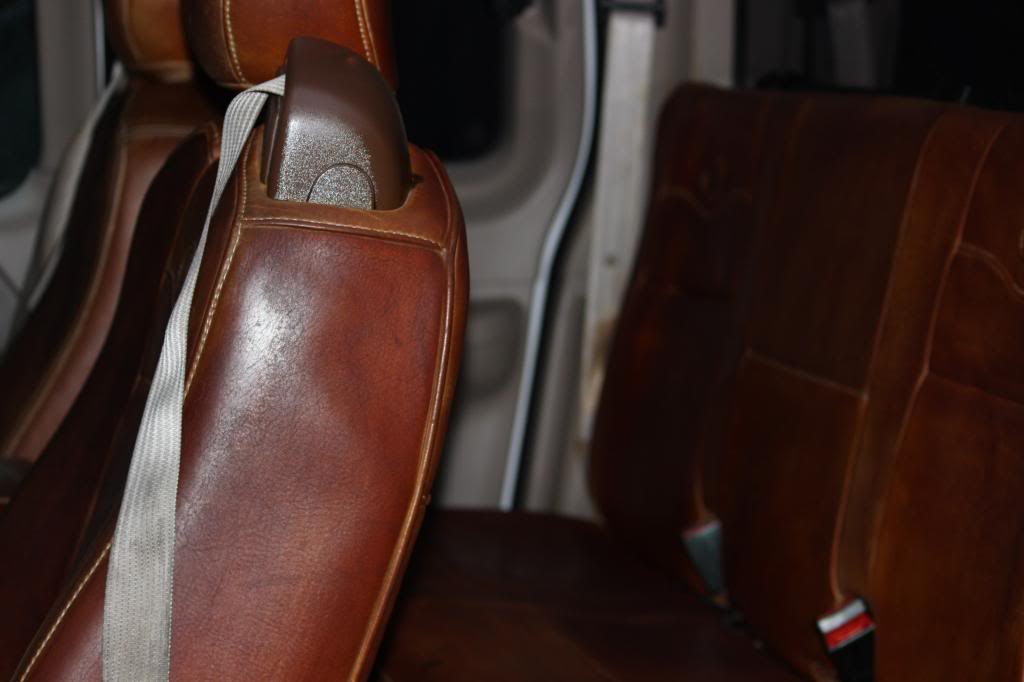

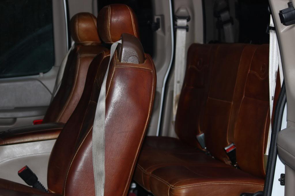

Ok, here is the after
again your mileage may vary. I'm happy with the results.
