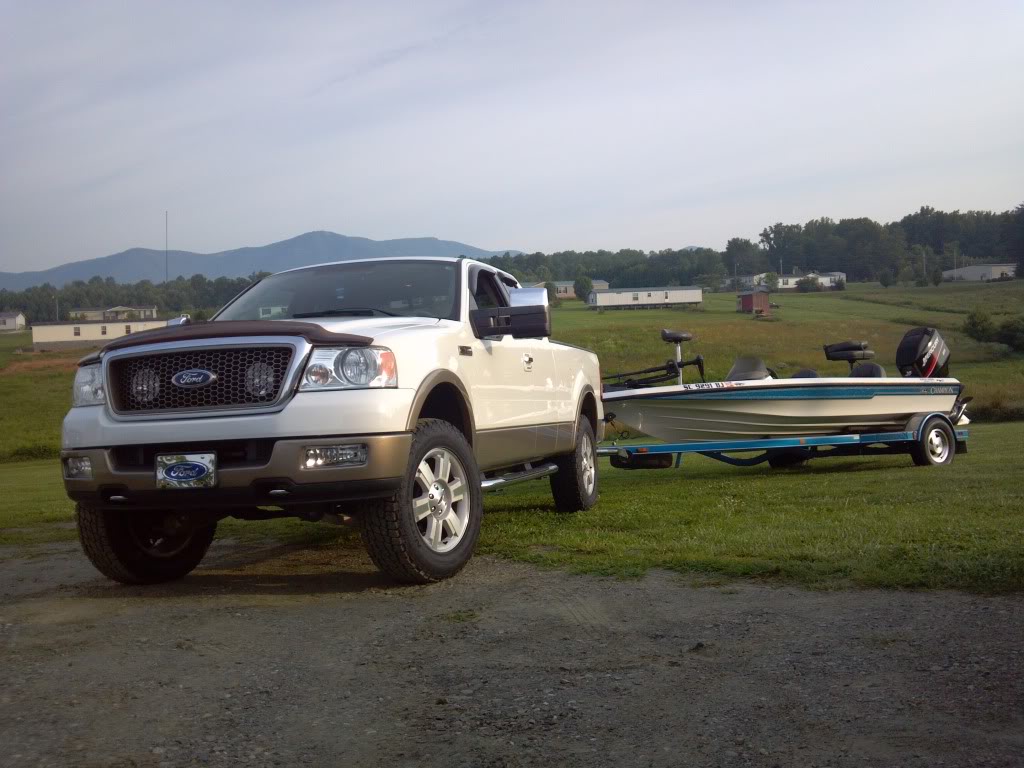

I run a 275/65R20 Nitto Terra Grappler on my 2.5" leveled 04 lariat. No rubbing whatsoever. Its the equiv if a 34"x11". Looks awesome too. Thats the size i would go with in a BFG
I can turn wheels fully both sides with no rubbing anywhere
