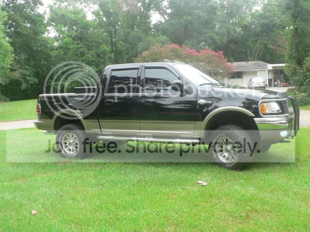

I am a new member today and I really havent gotten a staright answer from anbody so if anyone has done this or has any comment please let me know. I have a 2003 F-150 Supercrew 4x4 with a 3 inch body lift and 33x12.50 wranglers on it right now. I want to know if I can fit a 35x12.50 on there with only minor rubbing and cutting?
Thanks,
Paul
Heres a pic of it.

the 35x12.50 will fit. no cutting of inner fender well. some members report having to trim the valance, i did not on my 03. rubbing will depend upon your wheel width/backspacing. i'm running the stock wheels, and I only rub at the frame at full lock on sloped roads.

they endend up fitting pretty much perfect only alittle pit of trimming of the front valance not even noticeable.
