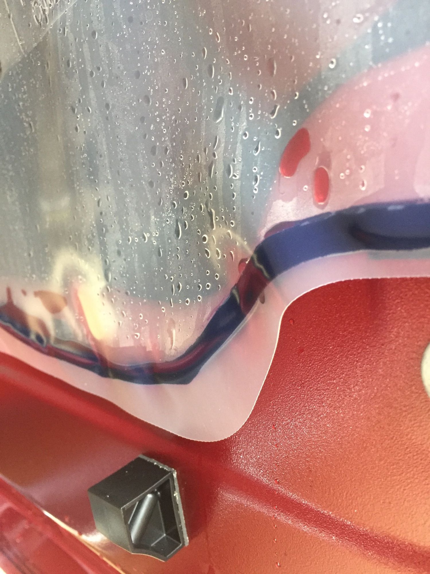

Hey I think I may have a remedy my 2018 was leaking on rear on both sides. Crew cab. Take the door panel off and there is a spot on both sides where the black seal on water shield wasn’t stuck to door. Reattached it. No more leaks for me

Thanks - i am going back to dealership for 6th time on Monday - going to take the pictures with me.
