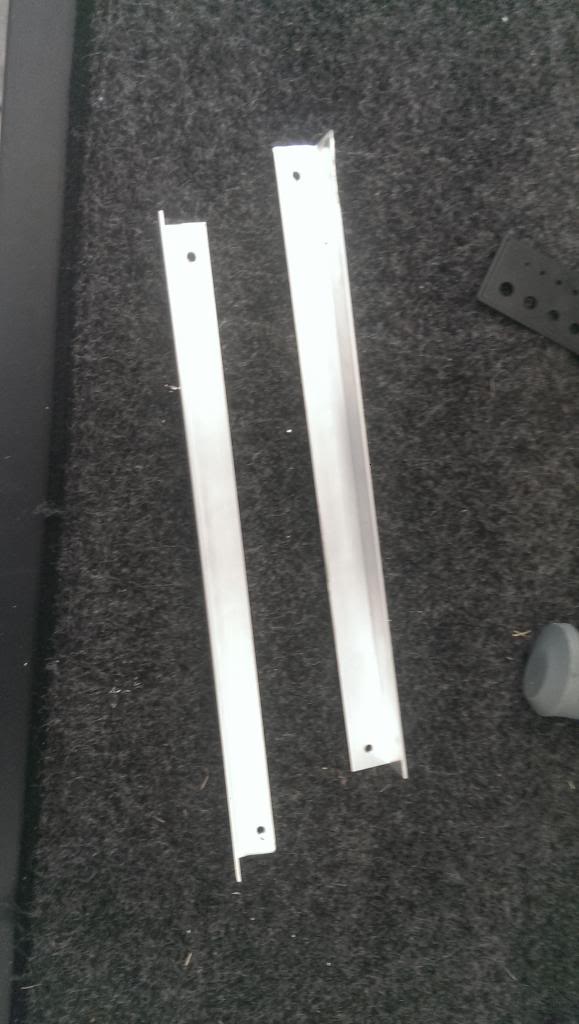

I found in Target a small leather organizer that will fit inside my console for $10. Then I got some aluminum railing for $6 at Lowes.
To do this I cut the railing at 11" each and then drilled two 9/64 holes on the end of each railing. I made such an odd size hole because I just used some small screws around the garage instead of buying more. Some small 1/8" holes would work just as well.

I plain on spray painting them I was just tied after hand screwing them for so long 4 times. If you steal it and your more than welcome to you'll understand haha. And I'll have to find the box for it but it was just under 10" long x 7" x 2" roughly. I had gone to craft places before looking for a simple small box and surprisingly I hadn't found any until now.
Old Dec 17, 2013 | 11:59 PM
greentitan05's Avatar
Joined: May 2013
Posts: 420
From: South Carolina
The railing was 36" and 1/2" tall and wide that I just cut off 11" each. And then I installed the railings about 5 5/8" off the bottom of the black hole so the box sat above where the hole curves down and gets bigger otherwise the railings would've been too far apart for the box to sit on them.
