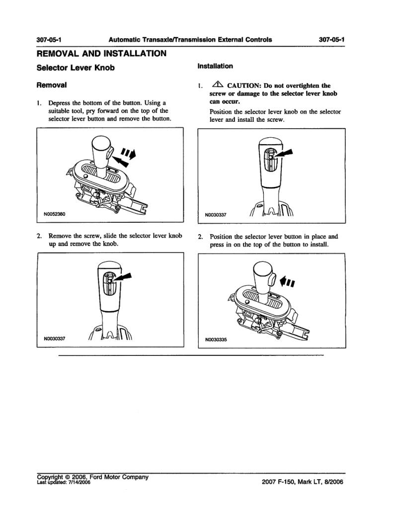

This may help:

another option is a mark LT shifter, its a direct replacement and looks alot nicer. the directions sam1947 posted are the same ones i used but i believe the 05 and 04 trucks are a little different
