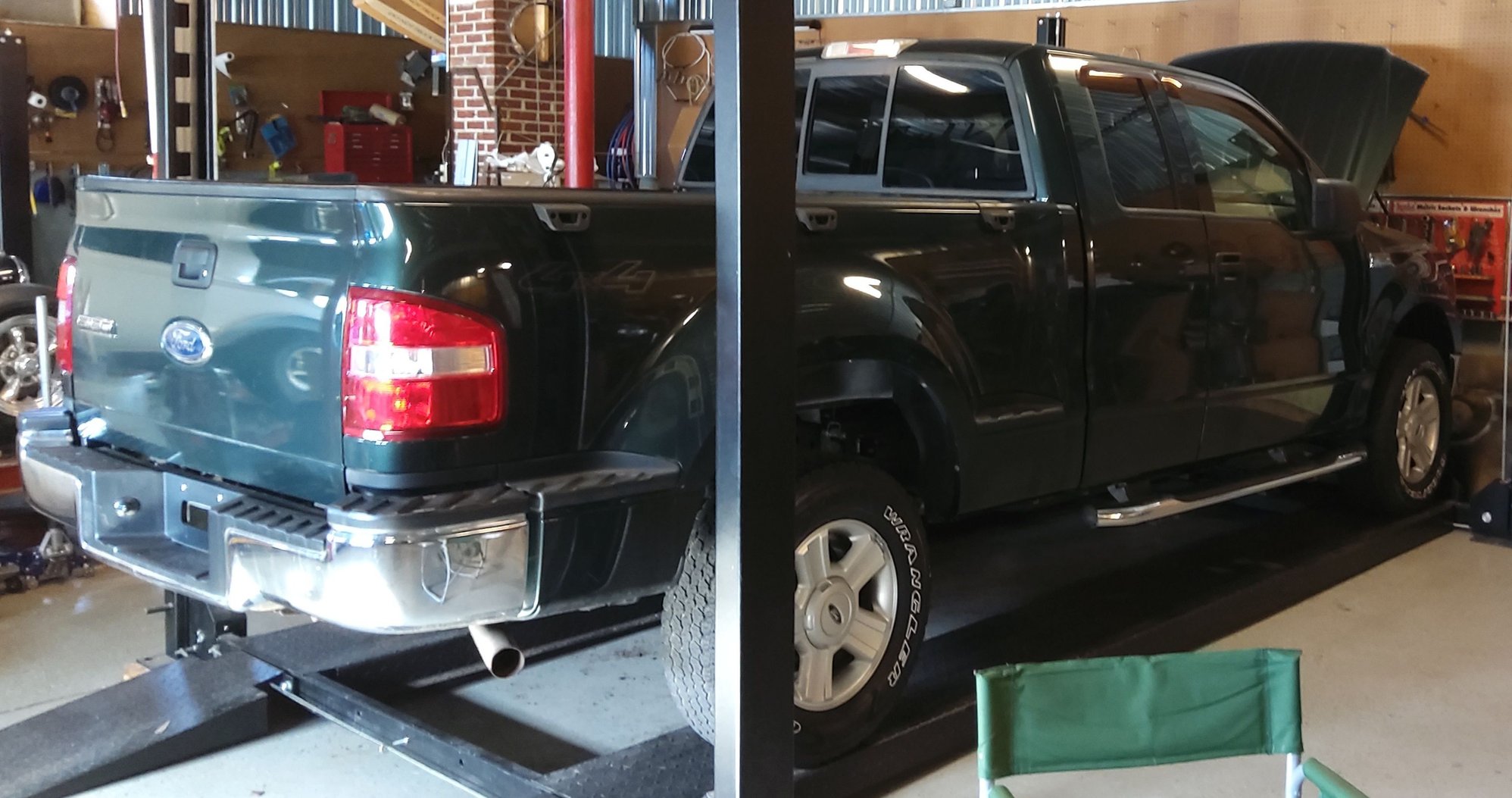

Im a used car lot. Just got this one. Is there badging that says Heritage. Nothing on this one if so. I took a photo. I'll try to attach it.
Old Feb 4, 2023 | 03:48 PM
Posts: 43,526
That's new body style.
