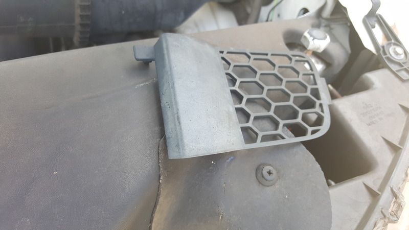

First thing is you are going to remove the small mesh grill. It pops right out exposing the two areas where you will be drilling to mount the mounts that hold the LED bar in place.

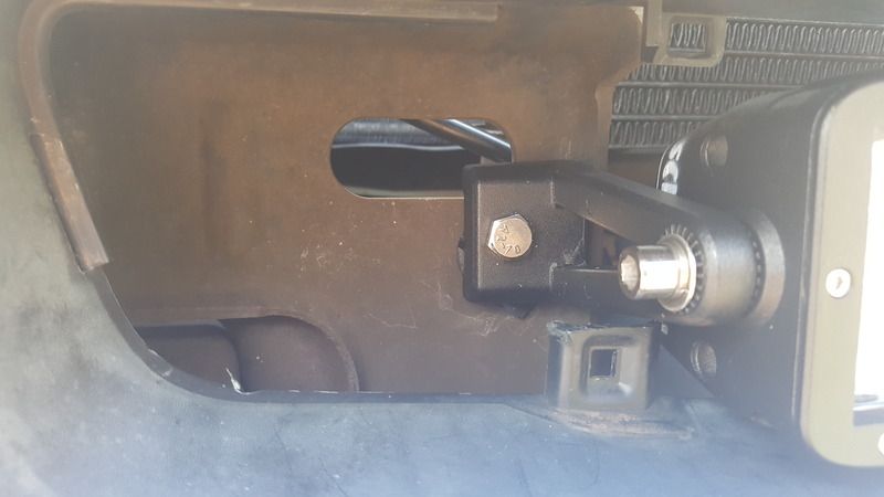

With the two sides of the mesh off...there is a metal plate in back of both sides. All you do is attach the mounts to the LED bar and place it where you want. Mark the hole where the screws will go to hold the mounts in place and drill away.
Drivers side
Passengers side

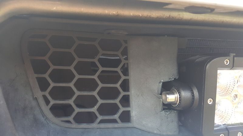

Next you will have to modify the mesh to make room for the mounts to come out. You can also adjust the LED bar without taking out the mesh grille..so that was a good thing about that. I did such a crappy job at cutting it....I just used a wire cutter and just cut until it didn't interfere with the mounts, but Im sure you can do a better job..lol!!!

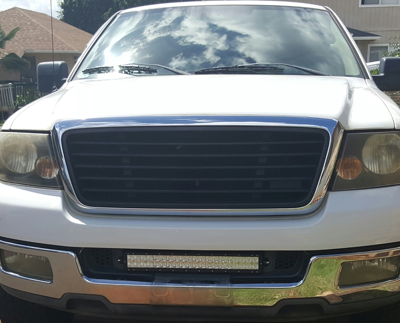

Finished product
