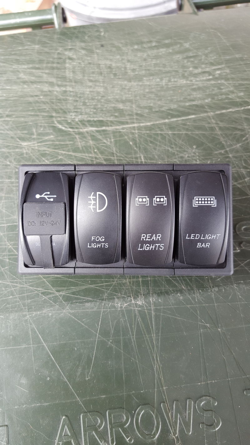

Those look pretty cool, Bryan316. These are mine all in the housing. But lighting will have to wait for now.
