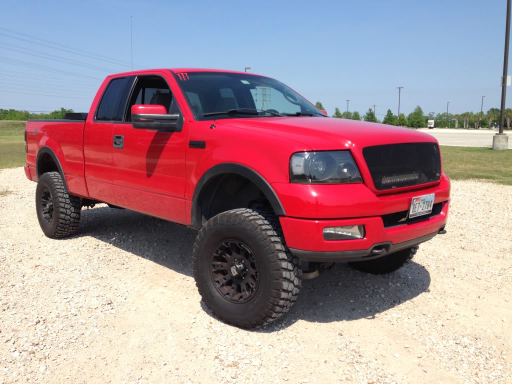

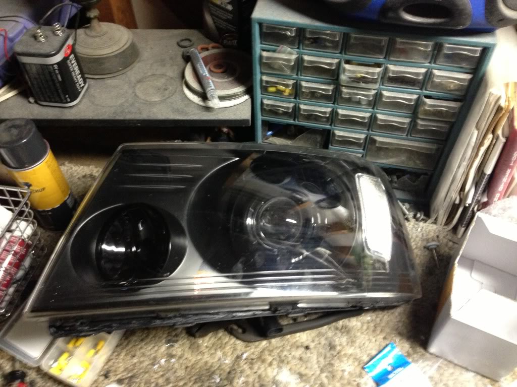

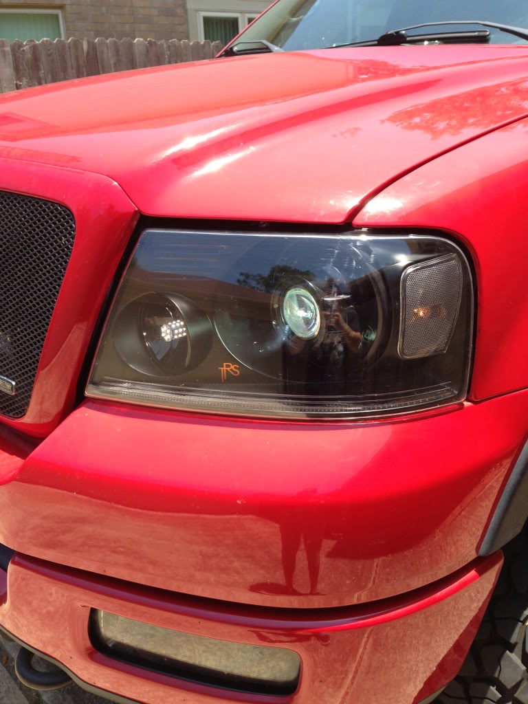

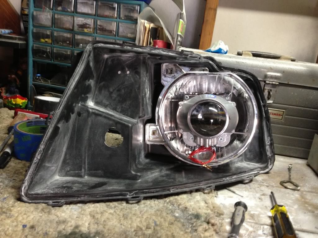

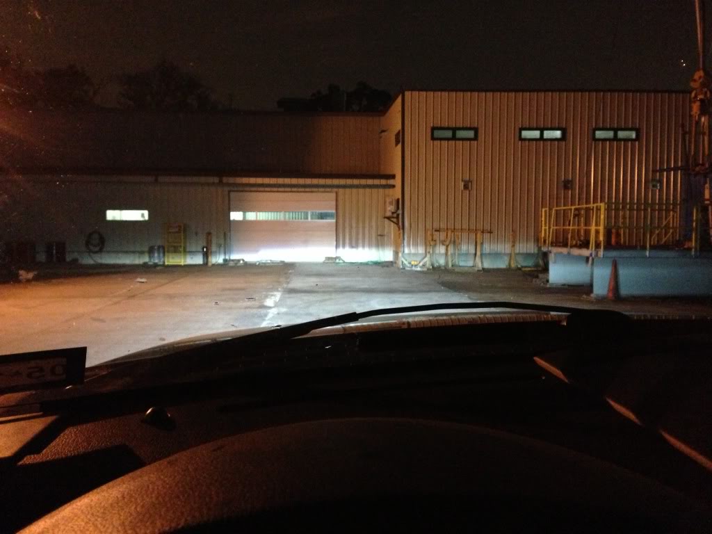

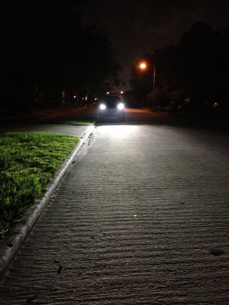

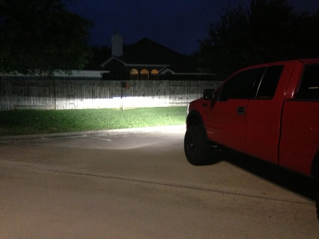

Like everyone else i'm upgrading from a DDM PnP kit. I had 6k and it was decent then moved down to 4500k for a more white look but the hid hot spots were bugging the crap out of me so FXR it was! overall i'm pretty satisfied with how it came out being my first retrofit, will definitely be doing it again though

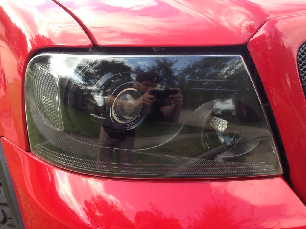

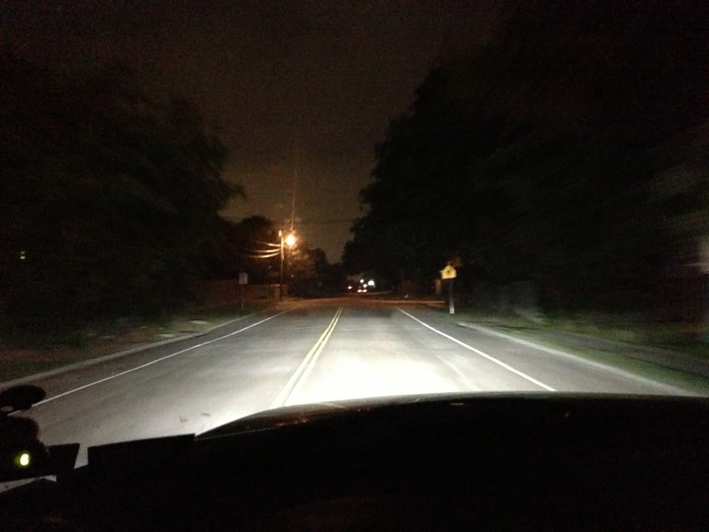

I'm pretty sure the passenger side is slightly rotated and i'm also not too sure on how high they're supposed to sit? they seem like they're shooting low, sorry for the low quality pics.

Looks great!
For the height find a level garage or parking lot, drive back 25 feet from a flat wall. Measure the height of the projectors on your truck. Turn your lights on. The left side of step should be 2-3 inches lower then the height of what you measured at your truck.. Ex. My projectors were at 40" on my truck and I set the left side of my step at 37"..
Just realized you are lifted. You might want a 3-4 inch drop.
