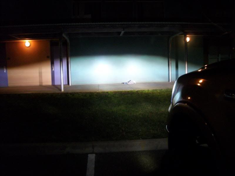

Light output appears bluer than it really is due to being a cell phone pic. 5000k 55w.
http://www.flickr.com/photos/arcticws6/6138044128/
Clean cutoff. These are the Mini H1 btw. About all that would fit without modifying the housing alot. The F150 headlights are A LOT bigger and can fit the FX-R a lot better.
